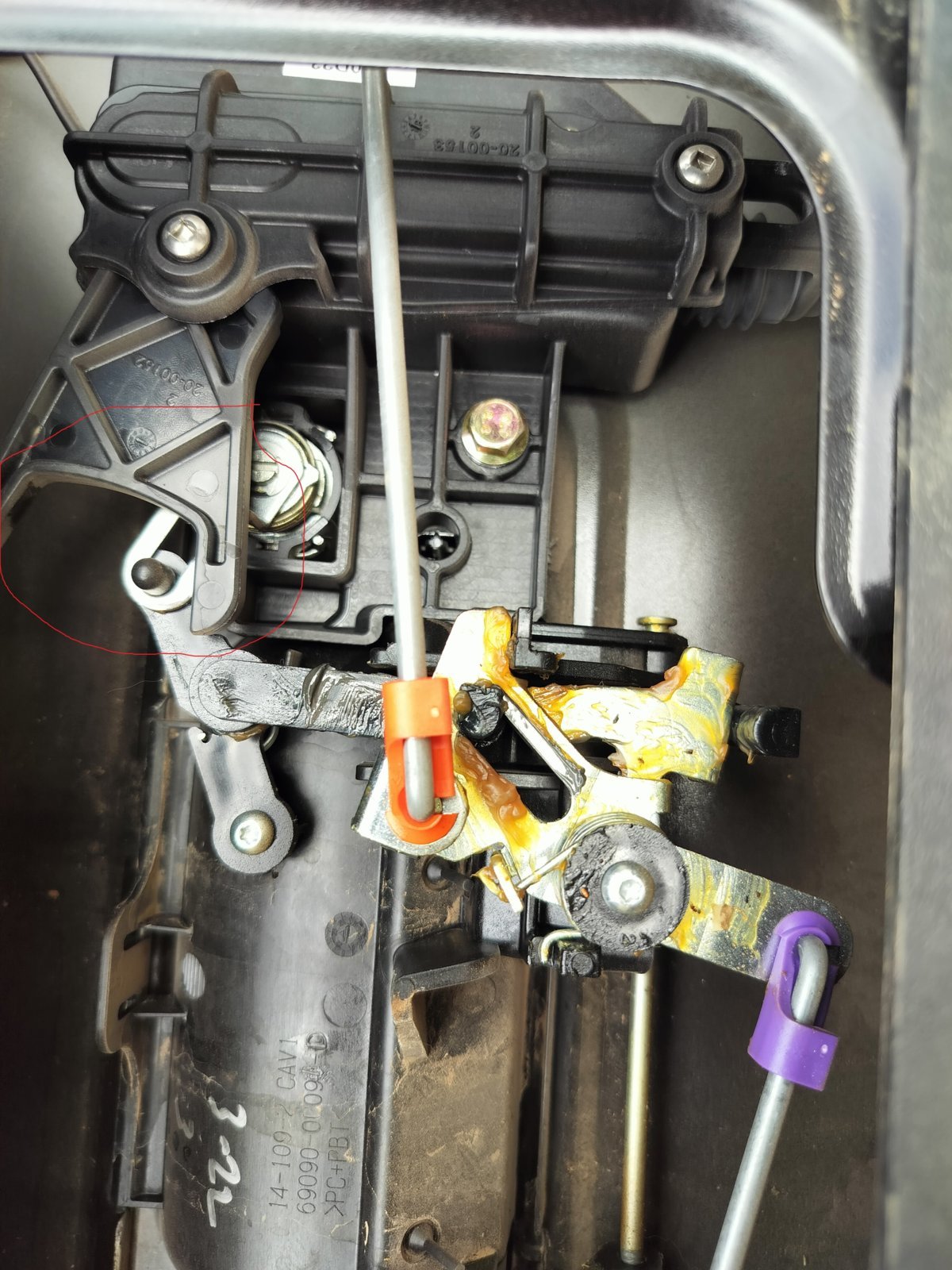

    Got a 2023 brand new with the OEM automatic tailgate lock from the fob, i am one week literally out of the accesories warranty, it will UNLOCK but not lock, the spot circled in red doesnt move enough, does it look like anything is missing from this photo? sucks only have 5k on the truck and have something i use daily break one week out of warranty, dumb. Any advice? it actually sounds like its moving and moves just barely, lubed it but no avail.

    Are you sure it’s not just an adjustment issue? I’m not familiar with how it works, but it looks like that linkage has a bolt securing it and maybe it’s a bit loose allowing the linkage to slip out of alignment so it doesn’t move as far?

    Are you able to post a video of it not working? I installed the OEM one on my '21 last week, but yours looks different than mine. Also, mine came with a locking nut for that nub on the right side of the "T" bar that goes into that metal slotted piece connected to the locking cylinder.
    I'm new to Tacomas but maybe someone on the forum can explain why your lock looks different than the OEM one I bought: PK3B6-35JS0

    here is a video of it, it tries to move but doesnt have enough power to move the lock when locking/unlocking.

    I wonder if that arm is adjustable and just needs moved upward a bit, to adjust it's range.

    tried to clean the grease off and relube, tried to take apart, retighten the bolts, nothing, its broken, damn it sucks because im pretty sure this is supposed to be OEM but installed pop and lock instead

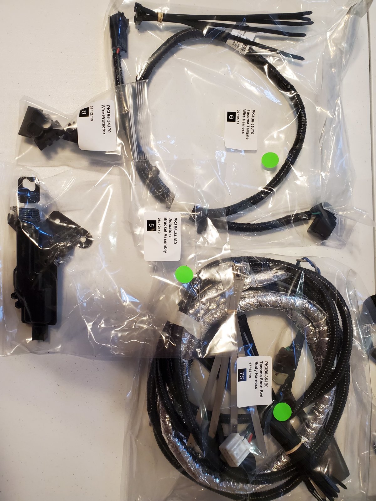

    I don't have any pictures of mine after installation, but this is a pic of the parts in the kit. I think the only kit that has the foil heat shield on the long cable to the tailgate where it passes near the exhaust is the OEM kit. I installed mine in March of 2020. It still works... knocks on wood... :)

    The difference is GST versus SET kits. They’re both PORT installed and not factory installed.

    You don’t understand Toyota… do your homework, SET and GST are EXCLUSIVES. Ever wonder why there are Tacoma SX or TSS? Why you can only get them in certain states? There are literally hundreds of port additions that are exclusive to either SET or GST. Why has SET had footwell lighting, but GST hasn’t? GST had tailgate electric before everyone. It was on my first two GST, but isn’t on my 2022 (SET).
