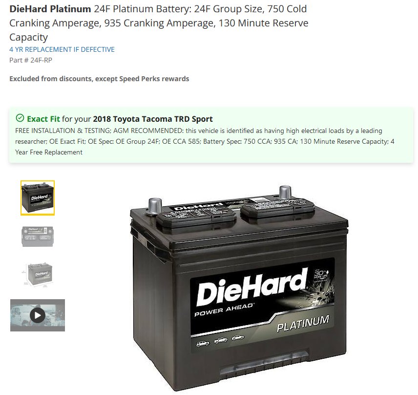

    Sporty2018
    Sporty2018 [OP] Member
    Jul 23, 2018
    #260320
    7
    2018 Barcelona Red Tacoma Sport 4WD Double Cab
    Seems a little ironic that I started this string last week - my battery crapped out last night just a couple days over 4 years and 7 months after I purchased truck with it just a little under the 70k mile mark. Thankful for the NOCO jump box. It got truck home. Then, had to jump again this morning to go get a battery. Put one of these in it - it's a 24F with 4-year replacement. I don't have any added on electrical equipment, so I feel like it'll work well for me just fine.
    Appreciate all the input on this string.
