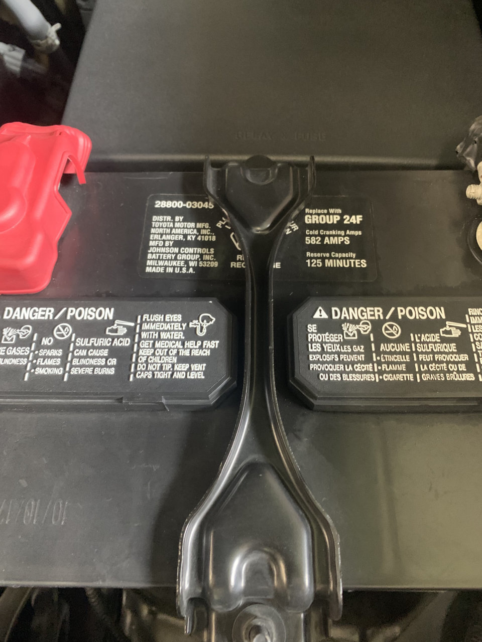

    I just popped the hood and noticed my factory battery says 24F on it. I was under the impression that trucks with tow hitches were equipped with 27F?

    Any advantage of going to a 27F AGM battery? What would be required to step up? A new tray? What else?

    I think second gen TRD's came with 27f; 3rd gens now only come with 24f
    More reserve capacity, but the trade off is more weight on the front of the truck and less CCA. You'll need a bigger tray/mount, a tune or battery tender as the 3rd gens alternator doesn't put out enough current to fully charge an AGM, and an aftermarket strap regardless of 24f or 27f.
    Again, I went with Walmart's Everstart 24F AGM. It's got plenty of juice of aftermarket stereo's, lights, and other accessories and a 4 year free replacement warranty for about $150ish. Also, recommend the Noco Genius 10 for charging. You won't find another AGM at that price point.

    That was only on 2nd Gen, all 3rd Gen's have 24F

    Thank you, both, for clarifying that for me.
