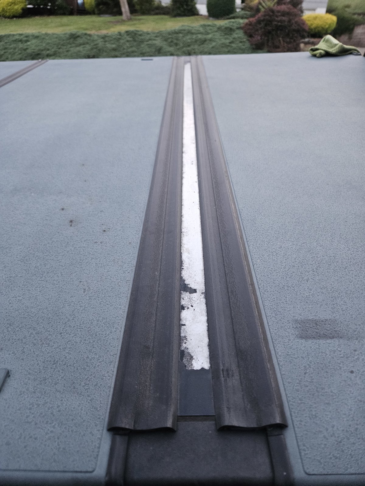

    I know there is a thread out there on this but I'm being lazy.
    Is there a way to fix the metal strip. So that it is black again. I saw there is a kit to replace the seals I think they are called on top too.
    If I'm doing all this work to fix the one piece. I probably should replace everything.
    Sorry if there is a thread already.

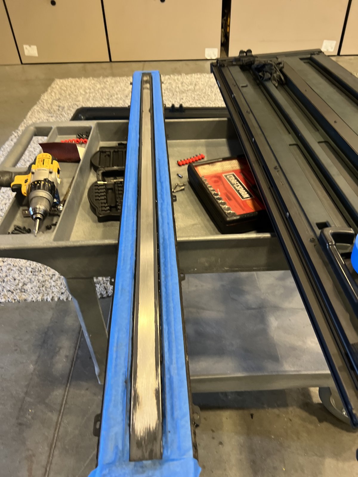

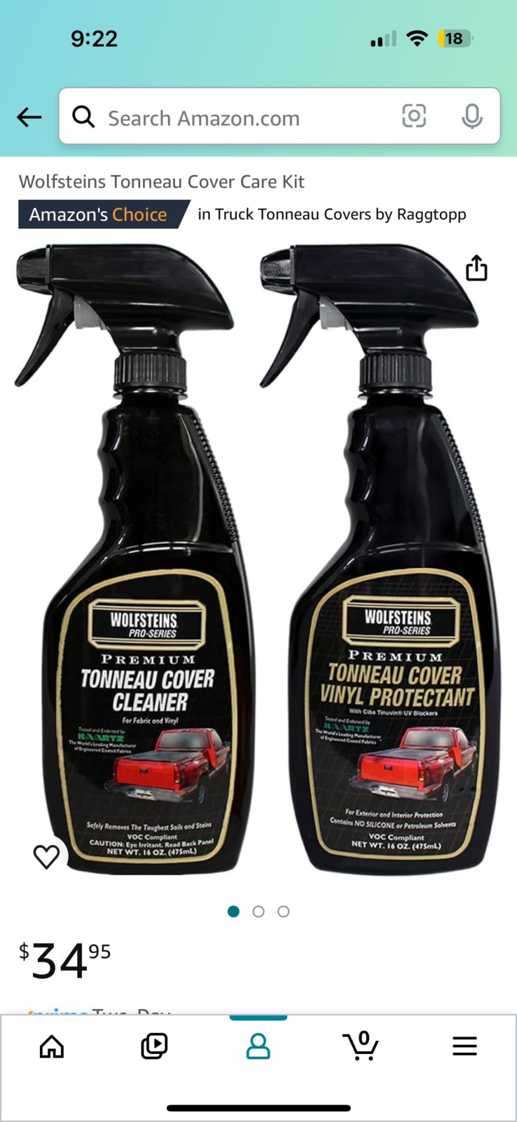

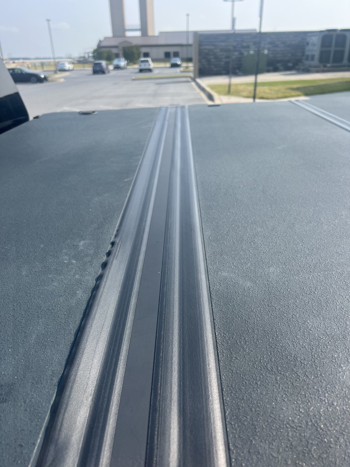

    IMG_0706.png If you want it black, gonna have to mask it, prime and paint. I have the same tonneau cover and mine use to be faded like that but I use this cleaner about every two months.

    I took it off and unscrewed both sides, sanded, primed and repainted it, then put it back together. I also replaced the seals and didn’t realize when I ripped off old one a portion of the plastic stayed in the track and gave me issues until I realized it was there and fully removed it

    Thanks gentlemen!
    I found the thread to replace the weather seals. He has a great video.
    Just wasn't sure if that metal piece could be replaced or just painted.
