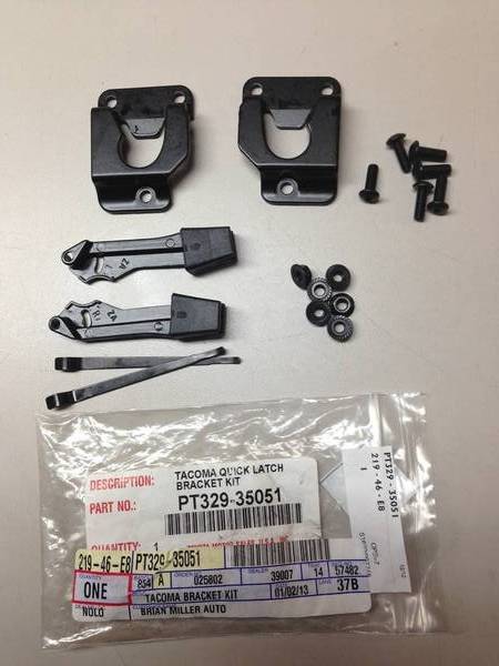

    ... ^^^ ... Hey, thanks for that posting those photos ... all I needed was the number for the mounting kit ... :D ... already had a new Tundra bed extender from a previous Tundra.
    Thanks again ... :D

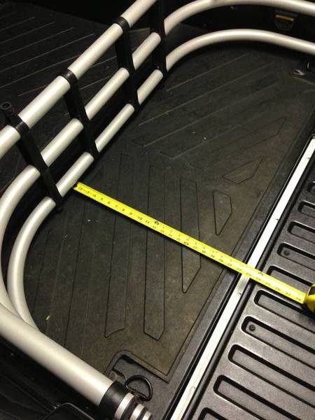

    I'm looking to put and extender into my truck. I have a full bed already with my 2 tool boxes. I'm looking for the measurement from the inside of the tail gate to the furthest point into the bed. I have 21.5 inches to the second box. The jack probably wont work in it's present position.

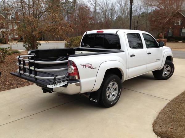

    Can anybody confirm whether the bed extender will fit under an Undercover Classic Bed Cover on a 2012?

    Someone? Maybe, please, give me that measurement on how far into the bed the extender extends into the bed?

    I measured the extender: From the tailgate it extends 22" into the bed.
    By your measurements, you may be able to make it fit by moving the brackets towards the tailgate. Might be worth looking into. Just my $0.02.

    My guess is yes. I measured my extender up from the bottom, it is 14.5". I have a BakFlip Hard cover installed and I have about 4" of clearance. Of course I have to open the cover to flip the extender out, but no issues.

    As for the jack, it may still work mounted as is: The brackets and pivots push the extender in a little and the thickness of your Hi-Lift may fit. The clearance on each side of the extender to the side of the bed is 3/4".

    a little over 22" is what i have

    I measure 22" as well. When rotating the extender in and out of the bed, it actually extends out about another inch, so you would need a minimum of 23" to clear. That's with the tailgate closed and tape measure on the bed floor.

    Man, you guys are great. That's the stuff right there that makes this forum so cool. Those are exactly the measurements that I was looking for. By what I' m reading and seeing from the photos, don't think it's going to work in my crowded bed. Thanks to all that took time for pics and answers. Bummer, I wanted that to work. Everything is already slap as far forward as it can go.

    Thanks for measuring, the Undercover has some support webs that hang lower than the top but that would be plenty of clearance

    When I traded in my Frontier for my Tacoma I kept the bed extender. They all seem to universal but does anyone know for sure if a Nissan bed extender will work on a Toyota? If so then I'll just use the part # from the the above posted picture and get the hardware kit. Forgot how handy extender was until I was shoving stuff in the cab on our last camping trip, lol.
