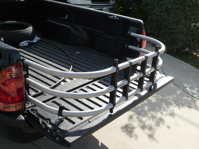

    What you need to know is the size of bed that the "Older" Bed Extender is for. If the Extender is for a 2nd Gen Tacoma, it should fit without a problem. If it's for 1st Gen Tacomas, you just need to find out the bed size and the dimension's of the extender. The extender's width is adjustable, so that shouldn't be a concern. You need to know the height. As long as the height is shorter than you bed's sides, it shouldn't cause problems. The great thing is that pretty much all bed extenders have adjustable widths, making finding one at a decent price fairly easy.
    When I mention height, I mean at the tallest point, which should be where the bumpers/feet are. The Tacoma Bed Extenders have two (2) bumpers/feet on the top and bottom that will touch the bed when not used, the tailgate when used.

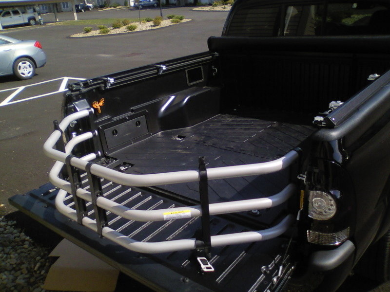

    Thanks to the OP for the writeup on this. Got mine and installed it Tuesday afternoon. Templates were nice and easy to get lined up. Pretty simple install.
    I did one thing a little different though. I used gasket maker on both sides of the holes before I put the bolts/nuts on. I figured this would work really well to make sure no water gets on that bare metal to rust those holes I just drilled.

    I have the old version on my '07 and since the bed is the same from 05-15, I don't see a reason why the older style would not work. New version looks a lot less useful.

    Looks like both are the AMP Research Bed X-tenders with Toyota's name on them. Looks like the 2012+ is the HD Sport style, and the 2005-2011 is the HD Max style. I would think either one fits any 2nd gen Taco.

    If you are talking about the older rounded-style one (not the one that has has the 45 degree angles on the side) --- it will fit a 2015. I installed the rounded one on mine. I didn't like the angled one ... it just didn't make sense to lose that extra space.

    Install was done 100% according to the included instructions. Just use the included template. My install procedure went something to the effect of : Measure --- then measure again --- and then nervously drill holes through the d-pillar of your brand new truck.
    The only thing I did that was a little different than the rest was to use gasket maker (It was this or something similar http://amzn.com/B0002UEN1U) instead of painting the holes that I drilled. This was done to prevent issues with water causing rust.
