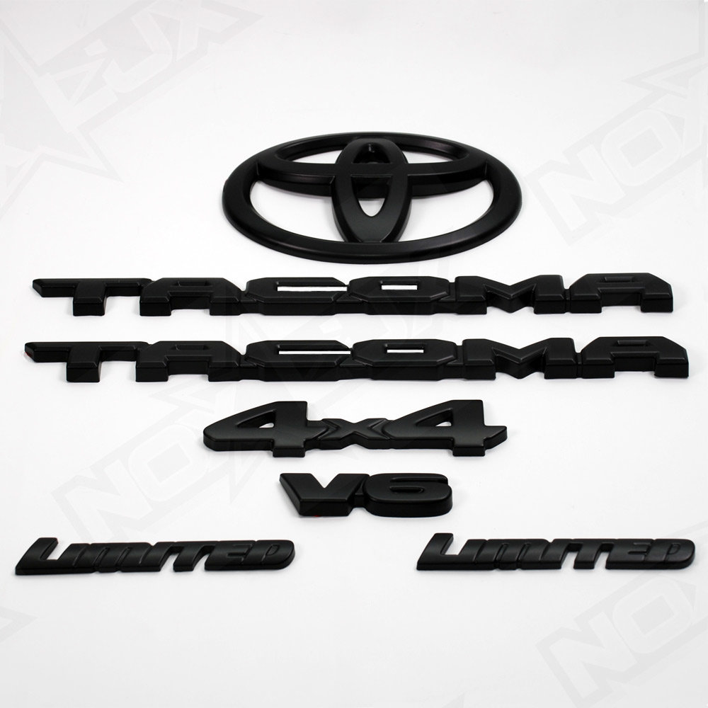

    They're definitely not genuine Toyota parts, and/or they are modified genuine Toyota parts. Unlikely because the packaging doesn't look legit.
    Toyota makes almost all of the nameplates/emblems for the Tacoma in black, except the 2016+ door ones that say Tacoma. (Only 2005-2015 style are available).
    As for holograms on the label, Toyota doesn't have holograms on their labels. The only part I can think of they do that for is oil filters and then it's just on the top of the box, not the label.

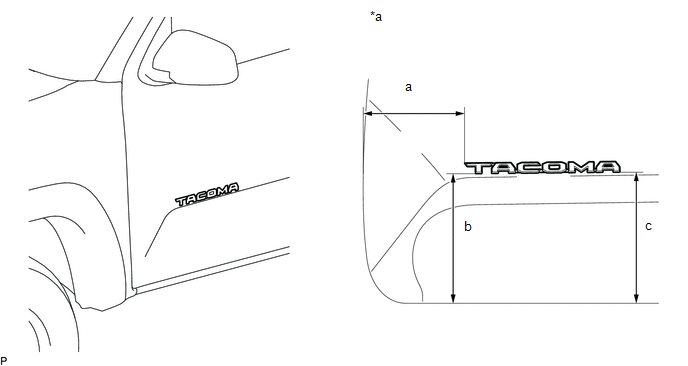

    For people wondering about nameplate placement:
    LH (Driver) Side:
    a = 220.1 mm (8.665 in.)
    b = 304.6 mm (11.992 in.)
    c = 308.7 mm (12.154 in.)
    RH (Passenger) Side:
    a = 218.4 mm (8.584 in.)
    Jeff

    As @Arcticdc5 posted, there is an update to my previous posts, which were true when posted, but no longer are. The 2021 Nightshade added black nameplates from the factory, these are not listed for the TRD Pro however... I actually believe the 2022 TRD Pro may just use the overlays.
    75427-04050 - Nameplate, Front Door RH ("Tacoma")
    75428-04030 - Nameplate, Front Door LH ("Tacoma") (The difference is likely a slightly different shape on the rear of it, but they are sometimes so close it doesn't really matter).
    75455-04010 - Nameplate, Rear Door ("Limited"); Qty: 2
    75473-04060 - Nameplate, Tail Gate ("V6")
    75473-04070 - Nameplate, Tail Gate ("4x4")
    Jeff
