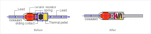

    It's called a thermal fuse, it's purpose is to blow if the resistor get's too hot due to insufficient airflow or over-current to prevent things from melting/burning.
