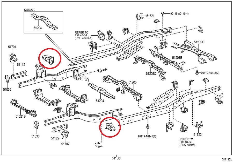

    Hi All,
    I'm looking for OEM front cab brackets. I know, everybody is cutting them off in favor of relocation brackets :p
    Do these even exist as a service part? I can not find them anywhere.
    I don't need extra clearance; one side is pretty corroded. I'll use of the available kits if it comes down to it.

    Those unfortunately aren't serviceable parts. They come with a new frame.

    First of all, welcome to the forum!
    Sometimes you got to go thru the back door.
    Toymo has often used parts from one model to another. If you are serious about getting these I would suggest you look at roughly similar models from the approx. time frame such as the Hulux, 4Runner, Land Cruiser Prado, Hiace, etc. models that may be limited to other parts of the world.
    For fun I looked up a random 4Runner and immediately saw this part number for a cab mount:
    51703-35180
    Initially take a look at that. Now It is probably most certainly not the correct one as I spent no time trying refine an application but shows you that they are not pulling that trick on all models. You just got to expand your reach. You will also likely have to import the parts.

    @caribe makaira
    I don't want to be picky but you are now illustrating the shock tower and the OP is looking for cab mounts. I ran Part Number 51703-04010 and 51704-04010 you provided in your first post #4 above, for the cab mounts, through a number of dealer sites in the 48 and all indicate that it is a discontinued part, or not available. I did not try elsewhere.
    Are these something available in PR?

    Yeah, my bad.:frusty: I was fast to verify the drawing vs the one on the parts store.
    No, no special warehouse over here...:(
