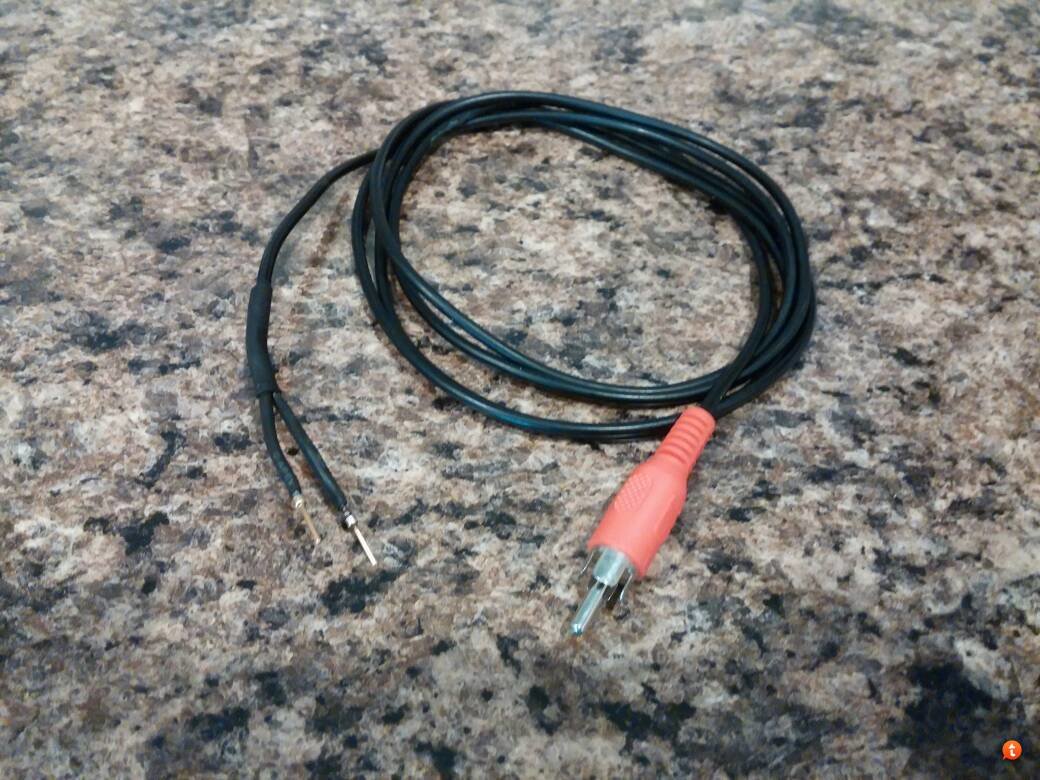

    Made my RCA and reverse light wires today! Easy to do and hope it works; my stereo will be here today and I will update my post.
    Ok, the V+ and V- work as described with the red/black behind the change tray.
    However, the red/white striped wire on the driver kick panel was not there on my 2011 (Double Cab TRD Sport Non-JBL). The top right wire in that harness was actually blue, and did not work. There was a solid red wire on the top left of the gray harness that I pinned into and worked perfectly! Now I have rear view camera on both my mirror and head unit (Kenwood DNX 7180). What a great mod, thanks OP!
