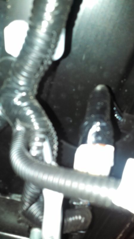

  20. Apr 24, 2015 at 6:04 AM
    #160
    boogerp
    boogerp New Member
    Apr 21, 2015
    #153623
    3
    TN
    '15 base
    I've read through several threads concerning being wired up to the radio for a backup camera. Here is the delima I have with my '15 truck. I show 4 wires going out of the connector but as I peeled back the conduit, , the wires end in a white tape and coming out the other end appears to be a coaxial cable (slit it open to look inside. I've attached a photo to show what I'm seeing. Does this mean I'm a no go for the wiring and need a supplemental harness? Sorry for the photo quality.
