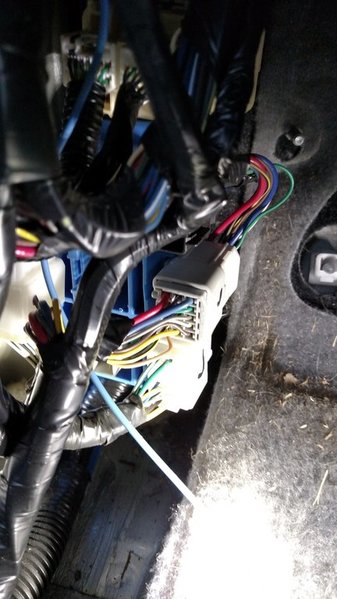

    So I've been searching throughout this whole thread and others for this answer...I have the video signal hooked up to my pioneer head unit but I cannot figure out what wire to connect the purple/white reverse sensor wire from the head unit. People have been discussing this but there is no clear answer on which wire to splice into. I tried using a voltmeter on the red/white/black/black shielded wires that are discussed in the beginning of this thread with no luck (the voltmeter did not get a reading when switched into reverse).
    Is there a wire to tap into behind the head unit since the purple/white wire is so short? Or do I need to extend the wire and run it down behind the driver side coin tray?
    If someone can just clearly say what wire to connect the purple/white reverse signal input wire I'd appreciate it.

    On my 2015, I know that the signal to the HU originates at the ECU behind the glovebox. The red wire shown in that bottom connector that I cut for my multiple camera install.IMG_20150912_164112233.jpg IMG_20150912_163915358.jpg

    I just installed a Kenwood DNX6960 and hooked up the RCA cable as described. I'm now having the exact same issue as jarett92: What to do with the purple/white wire from the HU? From the reply from Doug - I need to pull the glove box, find this plug and tap the purple/white wire into the red one from this plug?

    That signal should route to the HU, but I haven't pulled the HU to look for it. If you pull the connector behind the glovebox and use a multimeter to probe the available lines that run to the HU, you should be able to find it, I would think.

    I found the switched hot wire for witch to hook the infamous purple/white wire to. Its behind the glove box just to the right of cabin air filter. Top black connector and the wire is the top right red one to the right of yellow wire in this photo. Easy to tap into. I just made extension of purple white wire and tapped into this. Now reverse image shows automatically when in reverse. Thanks everyone. If it helps future users this is 2011 non jbl model.
