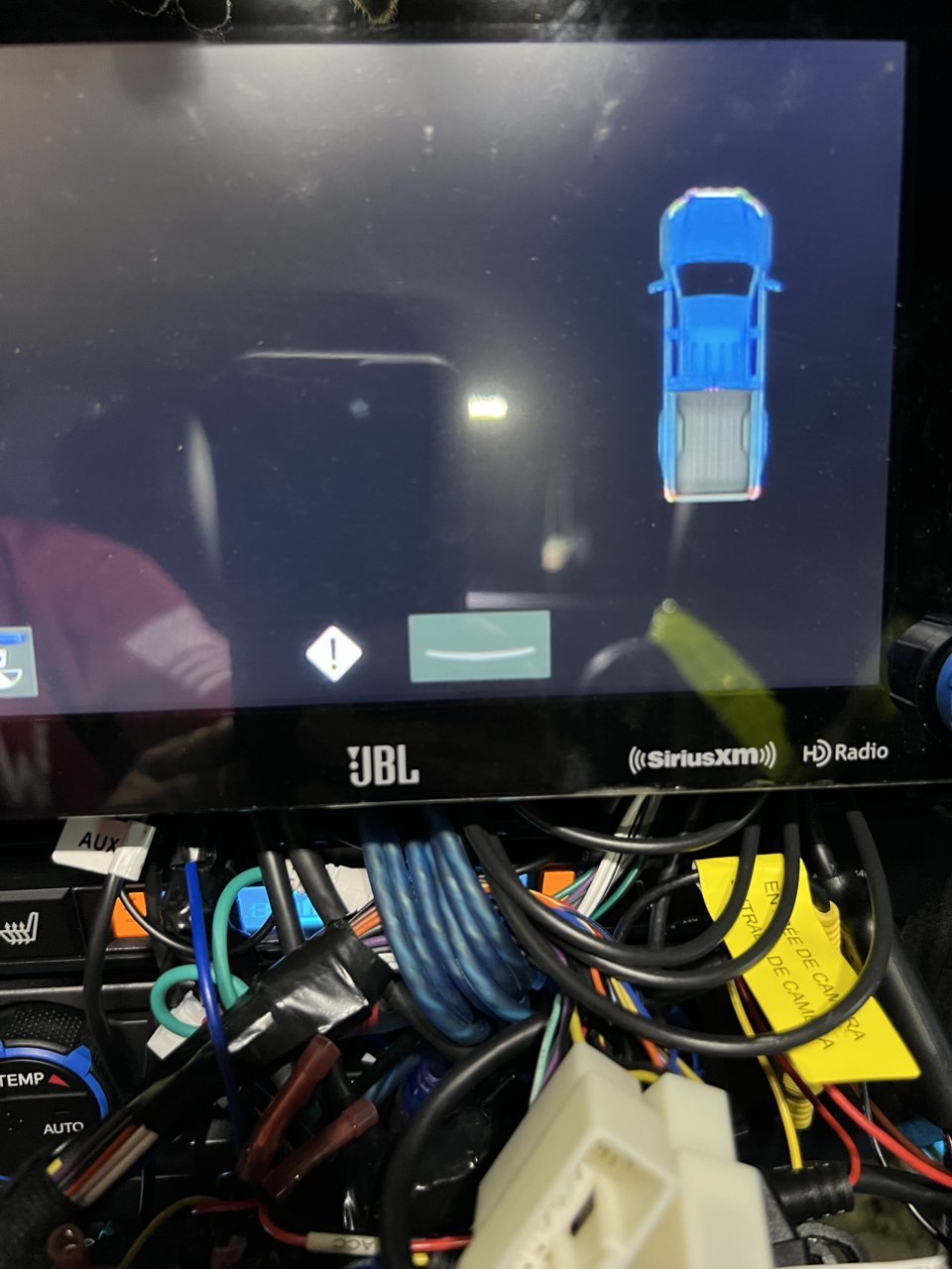

    Discovered this today.

    If it was professionally installed, take it back and have them fix it.

    They are at a loss as well. Still helping and suggesting but nothing resolved yet.

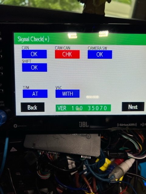

    If the 3rd gen is anything like the 2nd gen, the camera requires 6v. The Maestro can output 6v, but sometimes needs a custom flash from idatalink.
