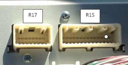

    Ok, I have done hours and hours of research on this topic and I know there are a whole bunch of threads on it but nothing has helped me thus far.
    I have a 2008 with no camera, mirror display, or wiring. I installed a 2013 touch screen.
    I have located the reverse signal and attached it to pin 2 in the 28 pin R15 harness.
    I connect the 4 wires of the camera to the R17 harness back of the deck but I am not getting signal.
    What am I missing?

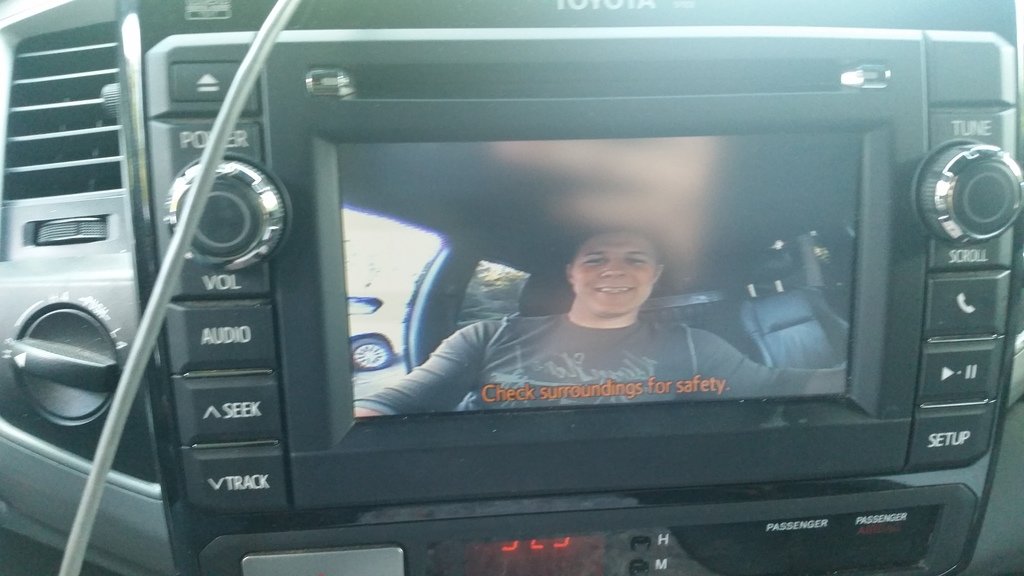

    FUCK YES...

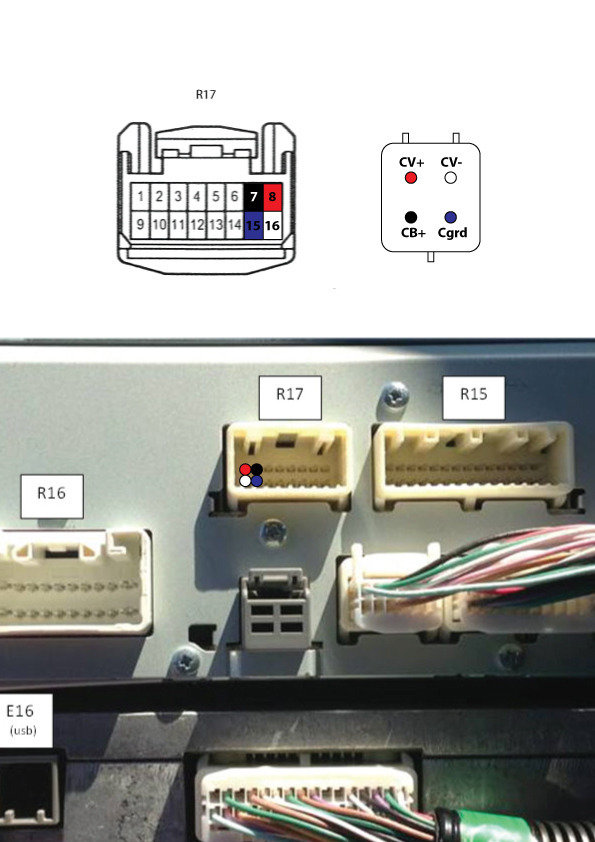

    I will keep updating the thread as I get closer but as of right now I found that these are the connections
    The 16-pin R17 plug goes directly into the back of the deck.
    R17 = tailgate harness wiring:
    7= Black
    8= Red
    15= Blue
    16= White

    This is a diagram that I tried to draw up:

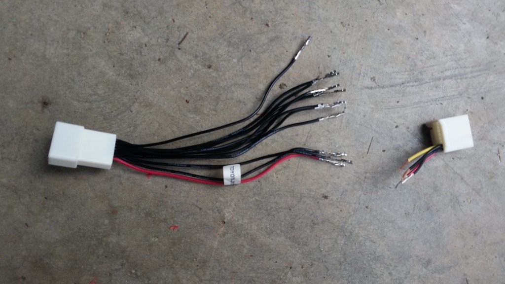

    Apparently Subaru and Toyota used similar head units. I found this diagram on a subaru forum and I know the 16-pin is right.
    I found two options:
    1pc CONNECTOR 16 PIN +10PIN CONECT FOR TOYOTA DVD BACK CAMERA
    $5 + $3 shipping and it takes 14-30 days
    http://www.ebay.com/itm/1pc-CONNECT...BACK-CAMERA-/151759577985?hash=item2355936381
    PAC CAM-TY11 Reverse/Backup Camera T-Harness Wiring For Subaru Scion & Toyota
    $23.35 Free shipping and it takes a week
    http://www.ebay.com/itm/271833919484
    (I purchased the expensive one because I want to finish this up asap)

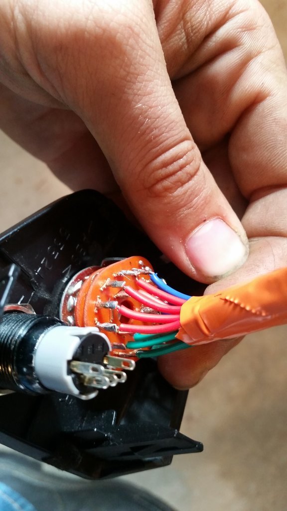

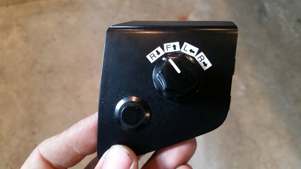

    I built this a long time ago to be able to switch between 4 different cameras (rear, front, left, and right) for trail clearance visibility. Since I have the camera working, I can finally finish this install. The push button switch is to trick the deck into thinking I am in reverse to make the camera work any time I want. This is that small interior panel piece on the passenger side. I believe this is for the passenger airbag switch in regular/access cabs.

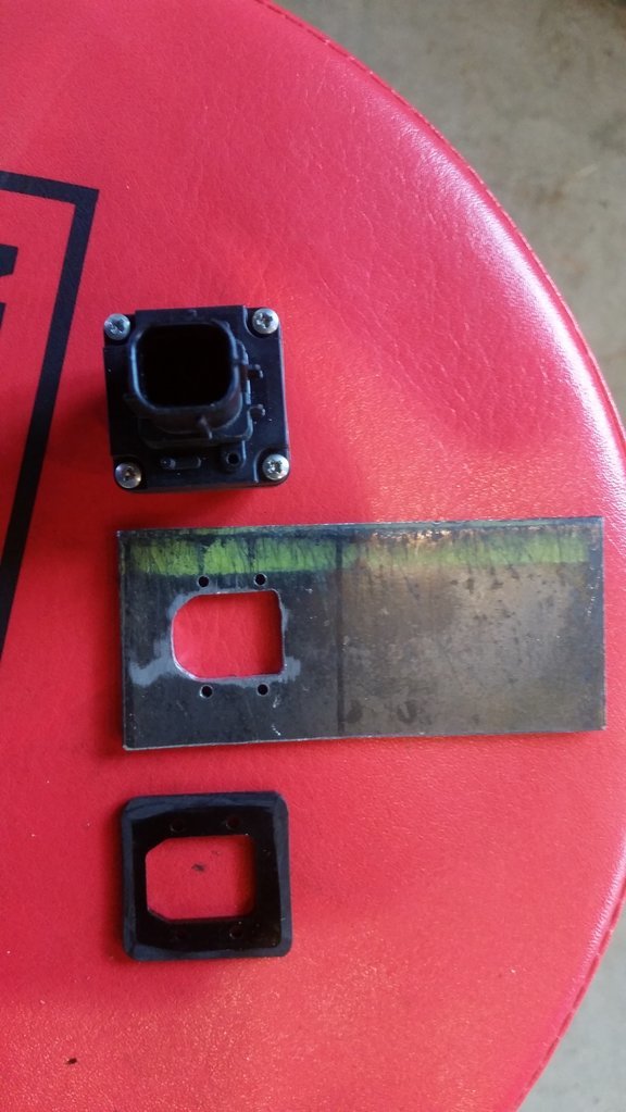

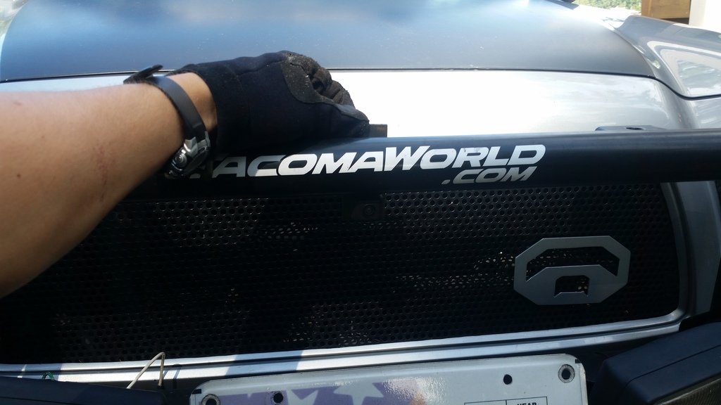

    I just made a mounting plate for the front camera and pretty much finished the wires for that.
    It's hard to see since it's black.

    I just looked back at the OP and it looks like I did write it down. I used pin 2 on the R15 connector for the reverse signal.
    That is this one:

    Today I received the R17 plug and got that portion finished up. I am making a housing for the front camera so that I don't bash it up on the trails but I had to move my license plate since it blocked 1/3 of the view.
