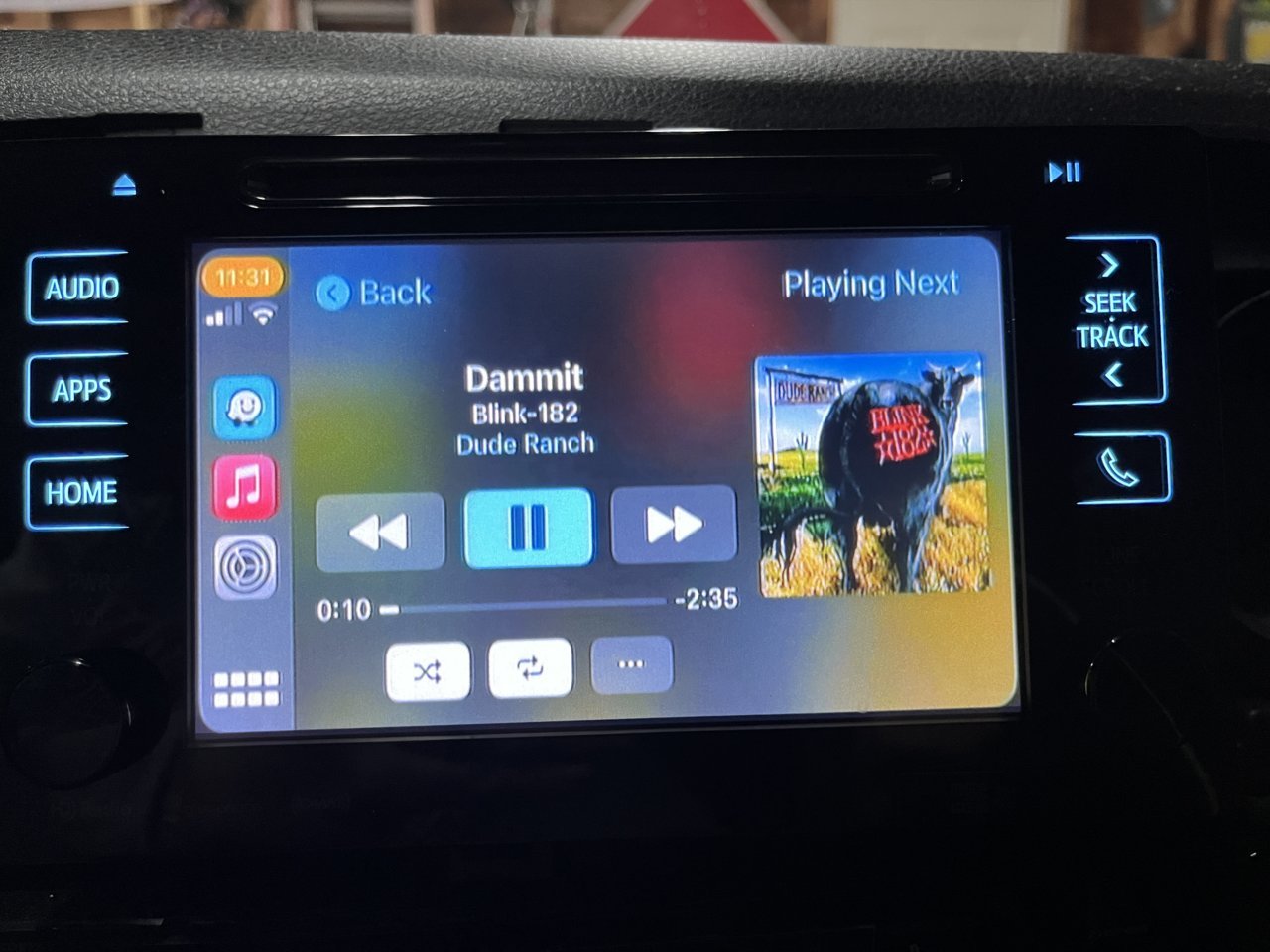

    IMG_3046.jpgThe basic user interface. You can see the quality reduction on the album art. This is about where the quality was on my Pioneer AVIC-D3 from 2007, or the Entune HU on my 2G.

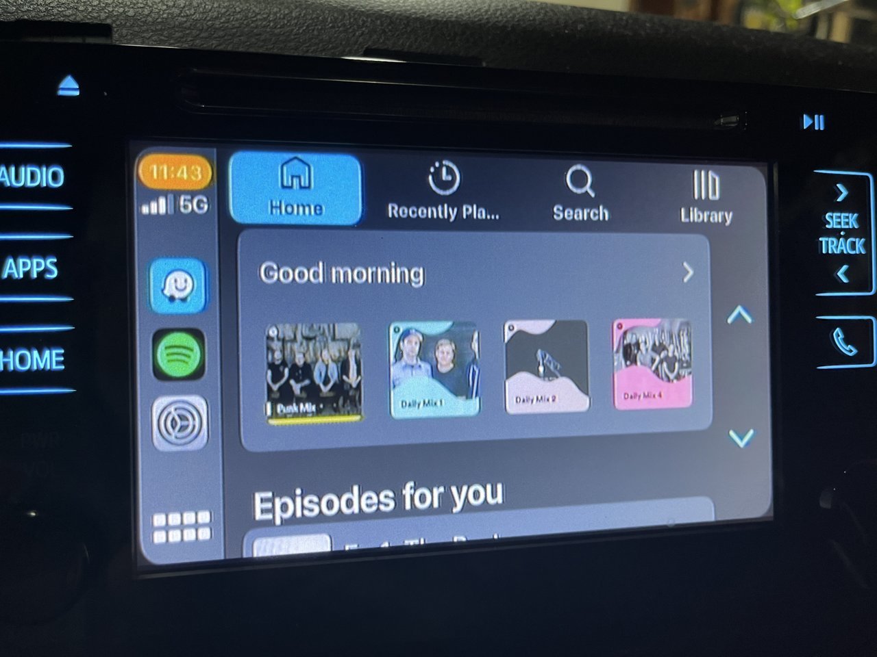

    The Spotify App again shows the issues with the interface, especially the text in "Punk Mix". Hardly the end of the world and a function of an older HU.

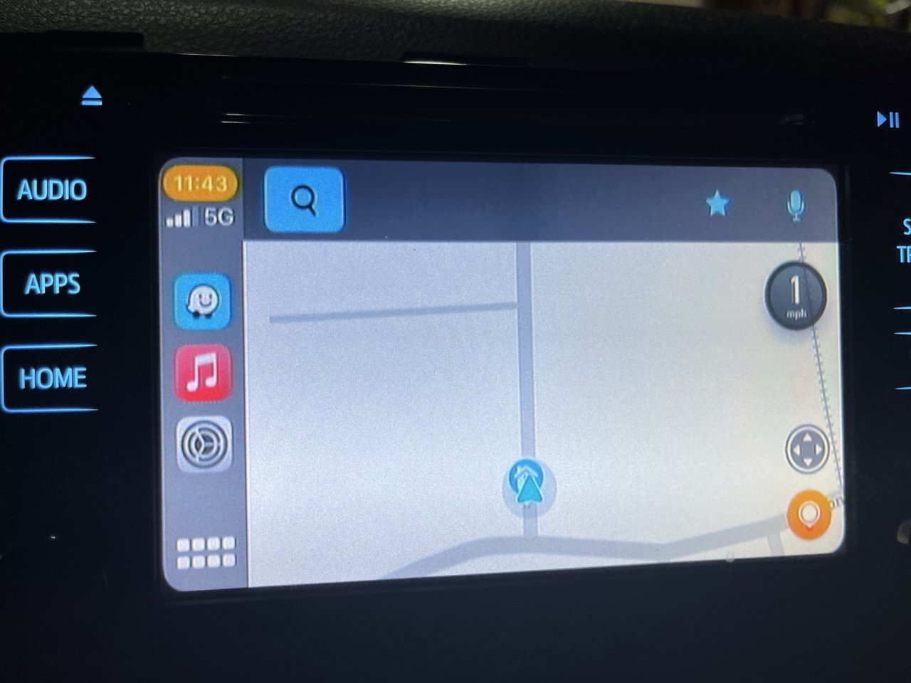

    I personally see no issues with the Waze app.
