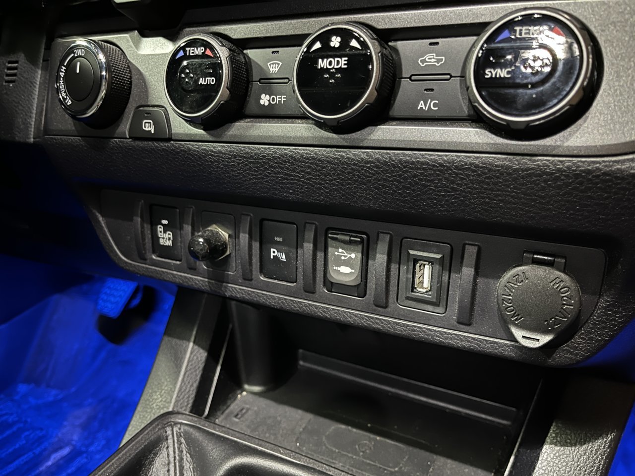

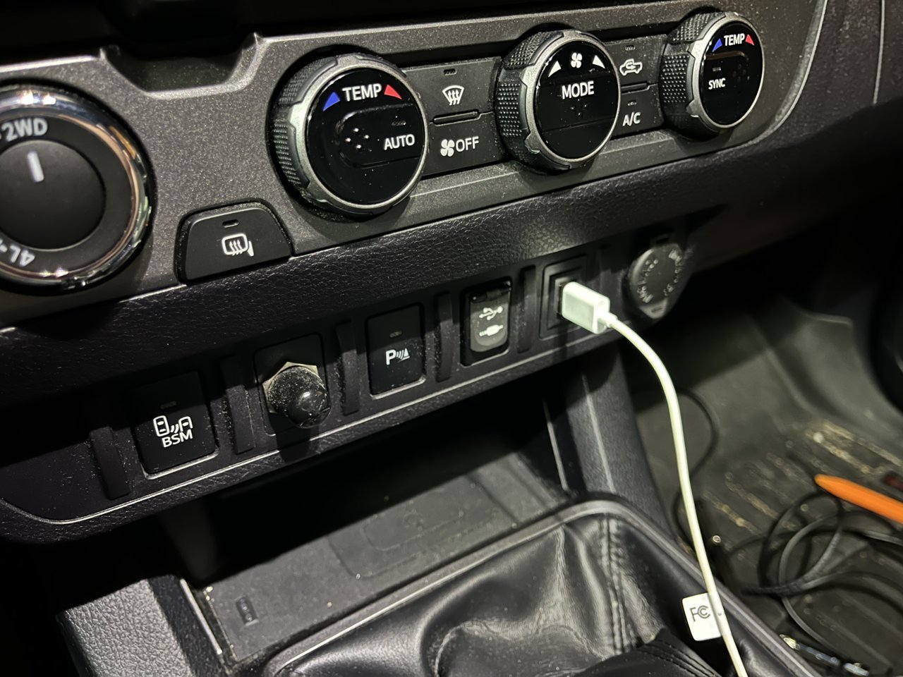

    Just an update on my install.
    I had my front passenger 6x9 go out on me, so I ripped the dash apart trying to figure out what was wrong. Long story short, it was a lose wire in the door, but it afforded me the opportunity to do some upgrades.
    • I added back in the unit antenna. I had removed it as I figured I'd be 100% wired, but I figure at this point there's zero downside to having the antenna on there and giving me the ability go go wireless if I wanted.
    • I had run a USB extension wire out of the unit down to the passenger footwell. I routed it under the console and popped it out at the cupholders. I ended up finding that in cold weather the cable would rub against the console making all kinds of annoying noise. I ran it to a panel mount USB switch in place of the Qi switch (see pics below).
    • I was worried that the unit would rattle in my dash as it was just placed in the dash. I placed the unit and wedged in some foam to keep it in place.
    I feel this switch gives me a much more OEM appearance. Let's be honest, it's a $9.99 shipped switch so the actual quality leaves a fair bit to be desired (it's loose in the dash) but it does work correctly. I am looking to see if I can find an insert that will cover the hole when I'm not using the cable.
    Pardon the dust, it's been a long winter. I'm still working on dialing in the audio quality. I'm close, but I'm still not there. I've found EQing the Aux and sending the audio one notch back to the rear seems to help with placement. The toughest thing is balancing volume versus clarity. I've backed off the master volume and the music volume on the app to try and get it so I can crank more volume without loss of clarity. The other thing I'm fighting is getting a good middle bass level trying to get some of the clarity in the bass while maintaining that 18-year old Mike thump. Of course, with a pair of car seat and the panels in the back of a Tacoma not being super tight it's always a trade off.
    I'll get there.

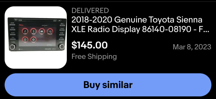

    Get a Sienna head unit off EBay then buy the plug and play harness!! No resolution problems. Backup camera quality seemed to improve for me too.

    That's an insane deal for that HU!

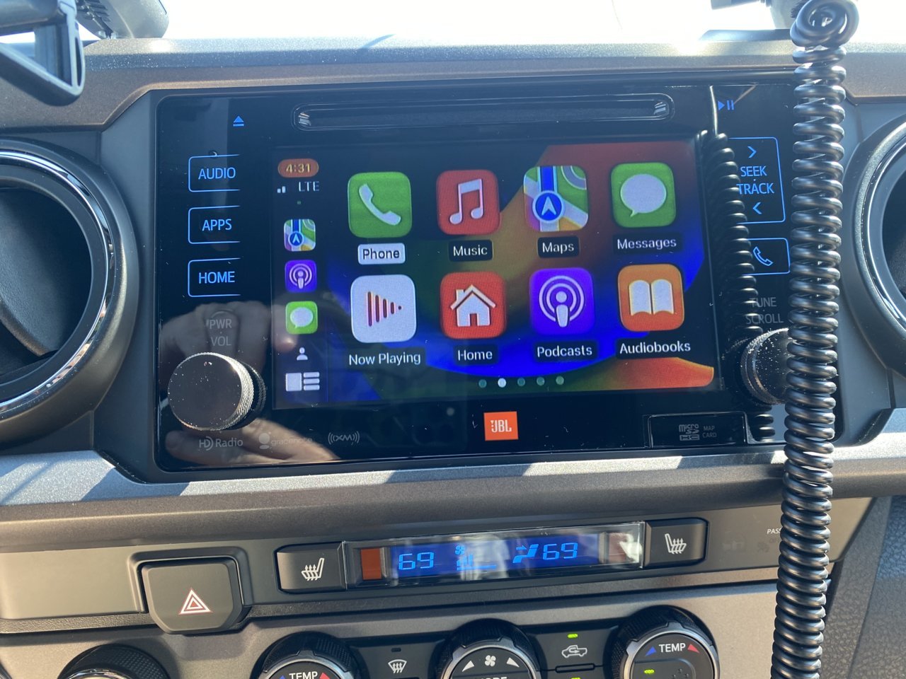

    I bought one of the CARABC units for my 2019 from Amazon based on this thread. I have the Entune 2.0 JBL system. Price was $189.
    It works! Based on advice in one of the install videos I went in the Entune Setup screen and set the camera contrast all the way to the left. This makes the CarPlay screen look about right, if slightly blurry. My eyesight is not great without reading glasses anyway and it’s sharp enough to read road names no problem. It’s no match for an Entune 3.0 unit in sharpness but may be good enough for occasional CarPlay users like me.
    The interface is very responsive. It boots up when I start the truck. I am using the wired connection to my iPhone 11.
    Sound quality is fine, although there is no EQ since the CarPlay adapter uses the AUX input, which doesn’t have the “sound” button that some other Entune inputs have. But the JBL system sounds pretty good with no EQ so it’s ok for me.
    I left my phone Bluetooth-linked to Entune. You can tap the volume/power button to switch back to Entune if you want to use that, and with it already connected this makes it seamless.
    Recommended if you’re looking for an inexpensive solution!
