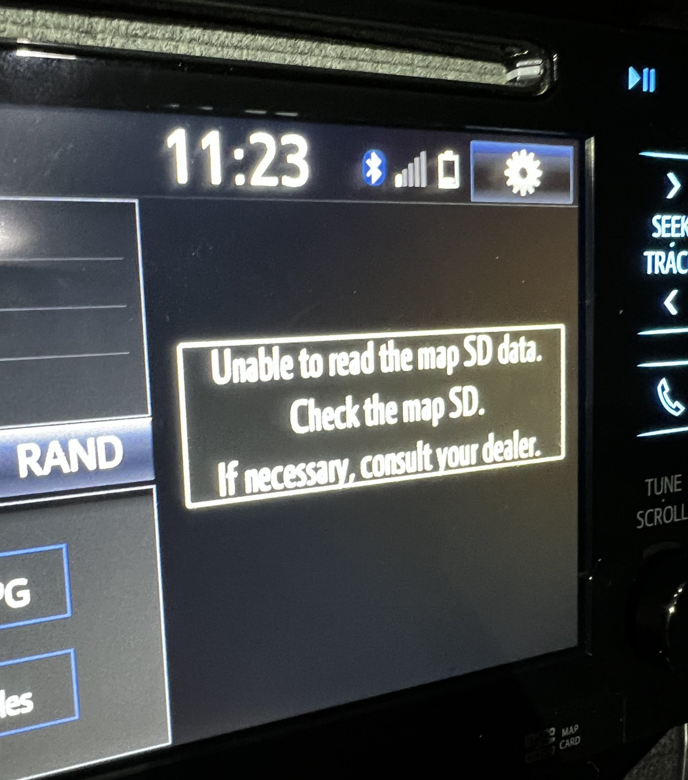

    I've seen that error a hand full of times on mine. I just assumed it was the cheap map card I bought off ebay.

    Did you ever get a solution to this error? I just installed mine last night, everything works except the oem GPS. Cords are plugged in, Micro SD card is in.

    I imagine it's the module itself causing the issue and won't be fixed unless it's removed

    I spoke with their rep via text and he stated he hasn't heard of this issue before. He had me recheck the connectors and making sure that they were not installed poorly. However, everything worked as intended. Anways, I bought a new 2024 (June 2023) SD Map off Amazon about a month ago. Surprisingly, the card had a "Toyota" text on it - not sure if it's genuine or not, but it worked after updating. Took about 10 minutes. No issues so far.
    I informed him that a few other people had this similar issue but again, he said he has no idea why this would happen.

    I had issues with my OEM NAV throwing the SD card error, after reseating the GPS port a few times it started working. This also affected the head unit's maintenance app as I could not reset any of the maintenance warning items after I installed the CarSyncTech unit. My only guess would be that the Quick SMA connector may not be seated properly.

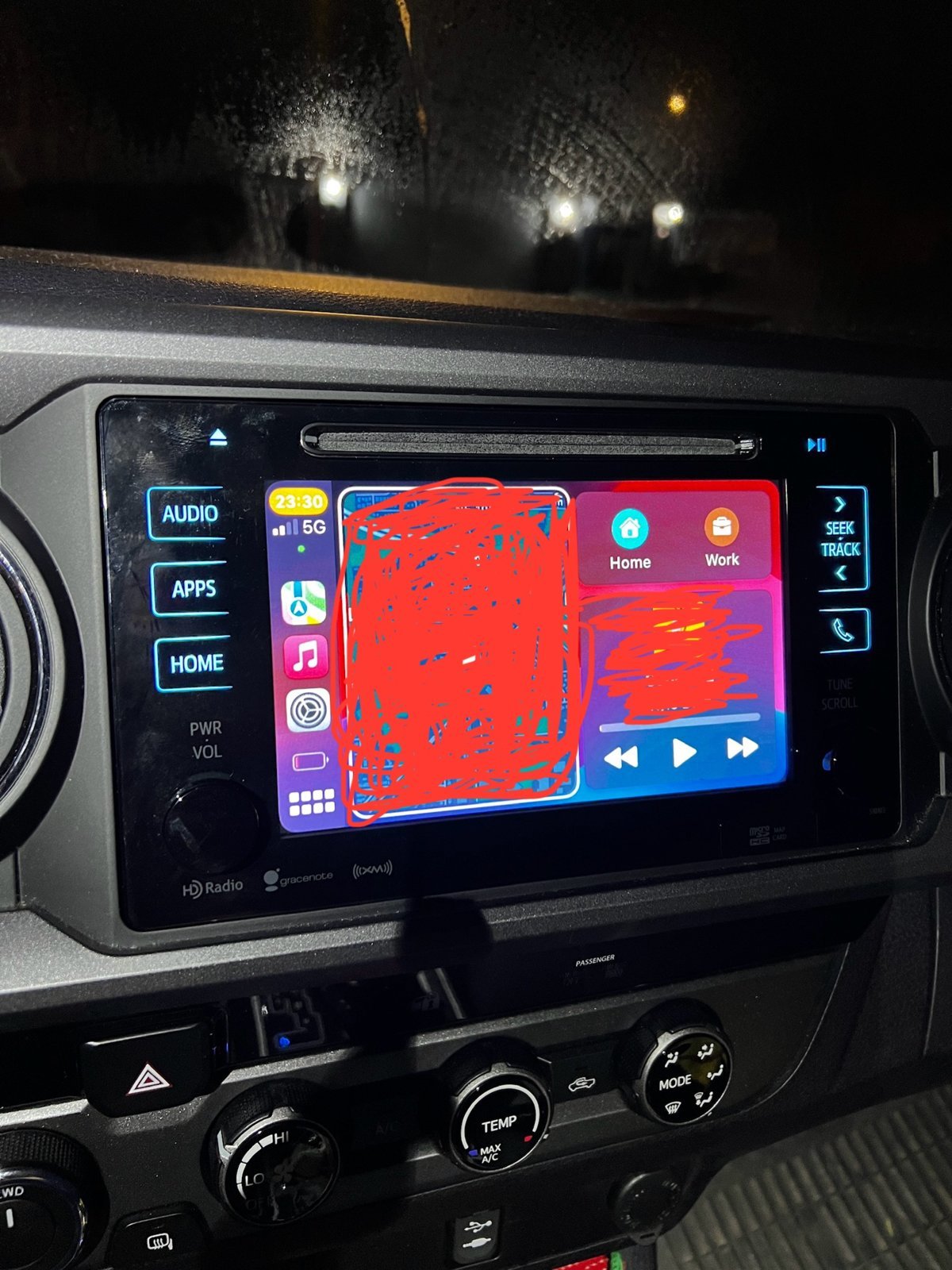

    I have now had the CarSyncTech module in for about 1 month and it has been working great. Install was easy, but it does seem like the ribbon cable is pinched somewhat. Time will tell if it is an issue. Picture quality is great on google maps and OnX. The audio is still coming in over factory bluetooth so it sounds the same. Bonus feature I can connect my wife's phone via bluetooth and display my phone on carplay so I can see the maps from my phone and she can control the music from her phone.

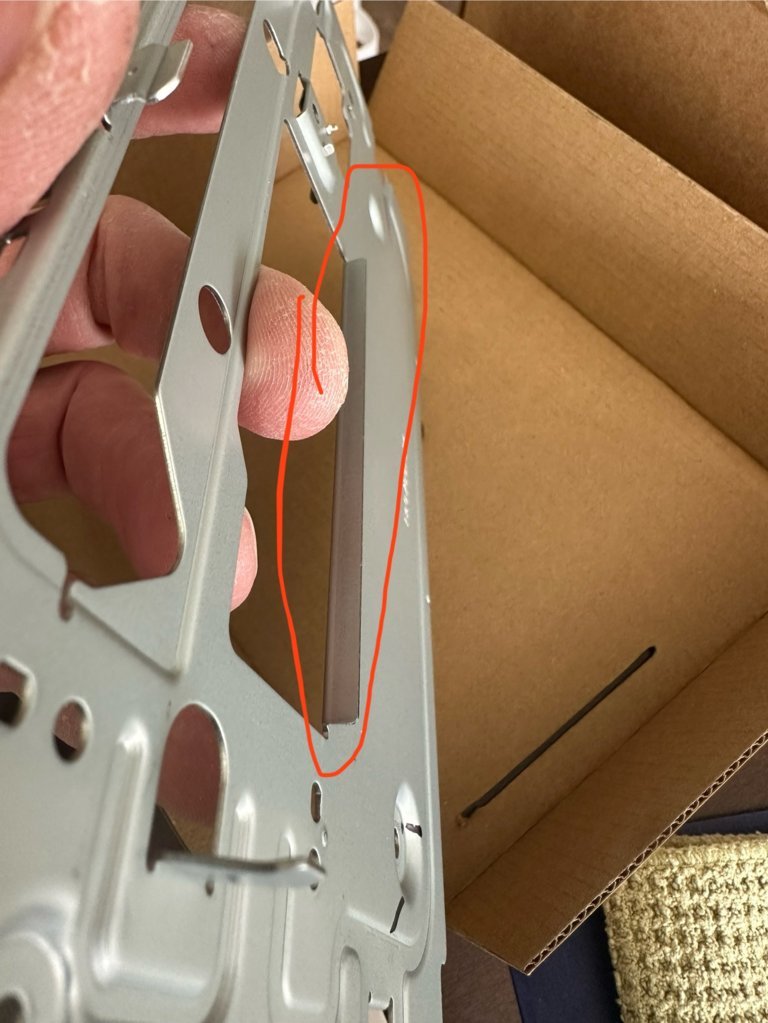

    upload_2024-12-15_12-6-15.jpg Trying to install my CST module now. However, on the head unit front bracket, this lip will seriously pinch the ribbon cables. Does it need to be removed, or do the cables take the punishment?

    Got ahold of CST support. No need to remove lip. Was a bear to hook up one ribbon, cause on the Toyota side, the locking bar for the small ribbon came off. A few patient minutes and it finally clicked back in.
