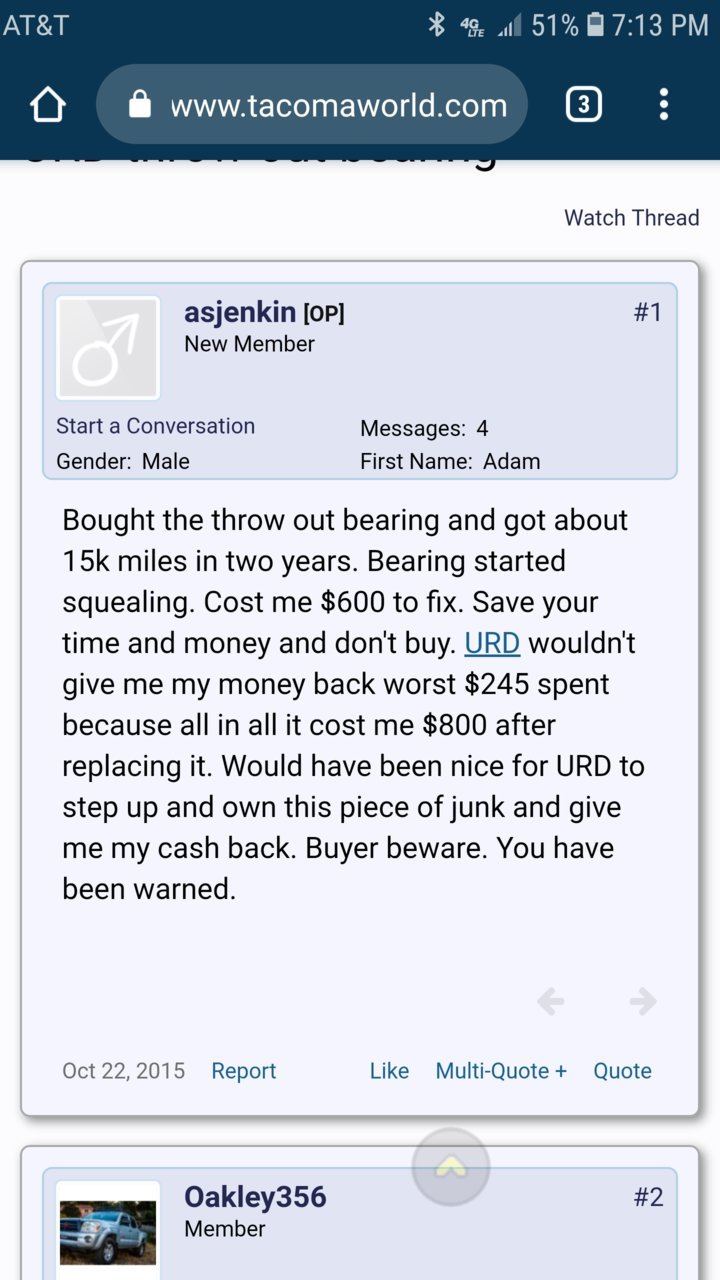

    Any Sqweek from the TOB?
    @eon_blue
    There was a guy that posted a sleeve or some sort of bearing that went over the throwout bearing or something like that. Do you remember what I'm talking about? I can't find it.

    Azusa, CA
    That might be the URD fix but I think it's only for 2nd gens

    I have no squeek from the urd tob as of right now
