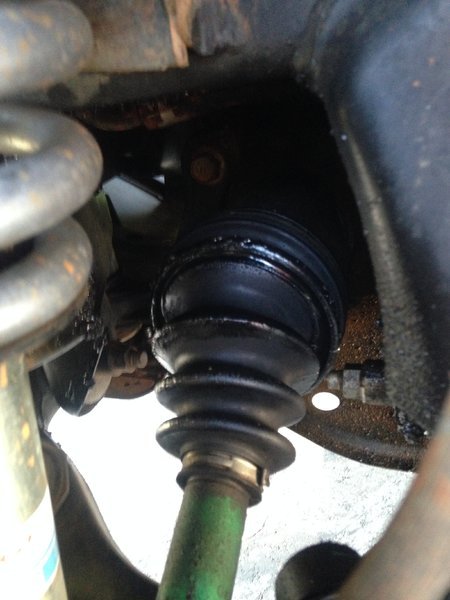

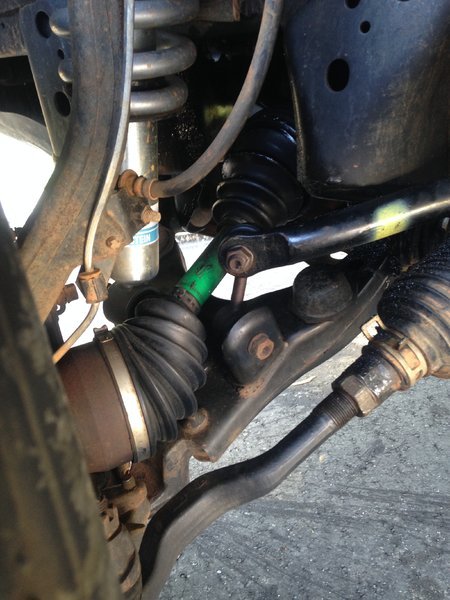

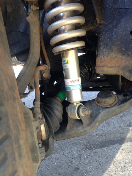

    Post a pic of your front CV joints and boots so we can see what we're dealing with here

    IMG_4296.jpg IMG_4295.jpg IMG_4297.jpg I'm at work right now so this is the best I can do.

    Holy shit. Do you even have ANY down travel?

    Holy shit dude. No wonder your CV boots are blowing. See how the ridges are touching? They shouldn't touch. That's way too much angle

    Dont look like 5100s are on bottom setting
    EDIT: reread your post and looks like you dont have them on bottom setting. with that coil they NEED to be on the bottom setting.

    FYI, the CVs should almost be a straight line from your front diff to the hub. At most there should be a few degrees of an up angle from the hub to the front diff. It looks like you have about 40 degrees of angle or more there. You need to drop that front down.

    The shocks should be at the lowest clip setting.

    Welp, you can officially call me the stupidest person in the world because I just went back and read about my lift kit and it says in all caps "DO NOT EXCEED BOTTOM CLIP SETTING OR DAMAGE WILL OCCUR". When I get a chance I'll lower the clips and hope that fixes the problem. My trucks ride has been pretty bad since I put that lift on and i never thought too much about it. Thanks everyone for the help.
