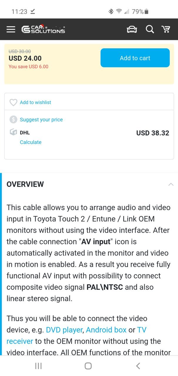

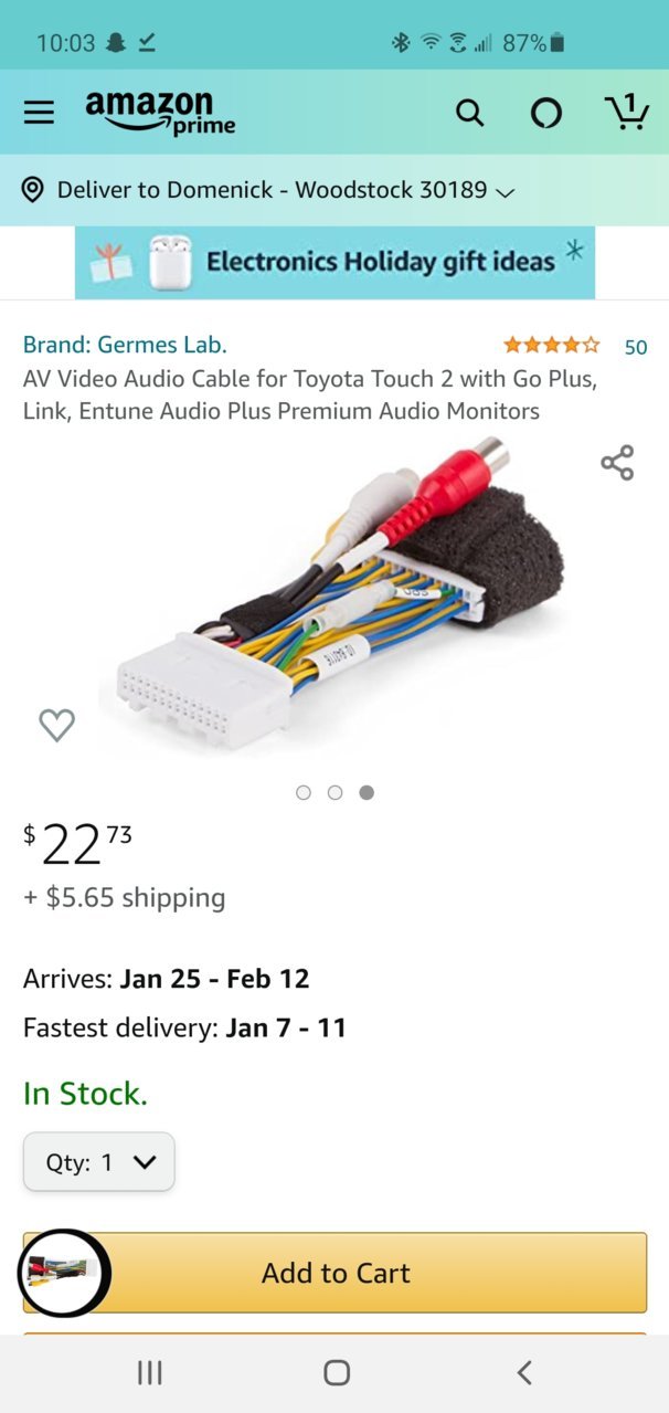

    Ive done some research but just trying to make sure I understand correctly and order the right stuff.
    So if i order this and plug it in, will i still have to do the pin jumps to see the source option or just plug in and be done

    I really can't tell, but I am not sure why that wasn't already done in the harness? If complete, that is a great price though.
    I have a different harness that I don't think is being made anymore. It was PnP though. The A/V input automatically showed up.
    Also, if you dislike Sirius / XM like I do, you can pull those connectors and the sat radio app will go away.

    I think I'll just pull the trigger and find out. I'll hold off on the hdmi converter and/or mirror device until I see if it works. I'll use an old DVD player to test
