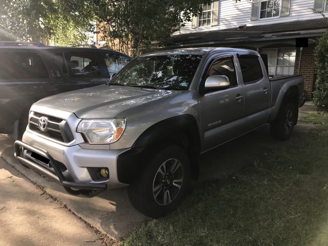

    Due to a painting mishap, I'm looking to replace the OEM flares on my 2015 DCLB with some standard OEM black flares. I found a guy with a 2008 single cab long bed who's willing to sell. I know that the "bumperette" is different between 05-11 and 12-15 trucks, but is everything else the same? Will SCLB flares play nice with my DCLB?

    Regular cab, access cab, and double cab long box flares are the same, double cab short box have the same front flares but different rear flares.
    2005-2015 are the same except for the front bumper extensions which are different between 2005-2011 and 2012-2015.
    52112-04050 and 52113-04050 are the front bumper flare extensions for the 2012-2015, they're not too bad to buy separately if you can't find them used to go with the rest of the 2008 set.

    Got the aforementioned fender flares installed yesterday. Perfect fit, as expected. Thanks again @Jeff Lange.
