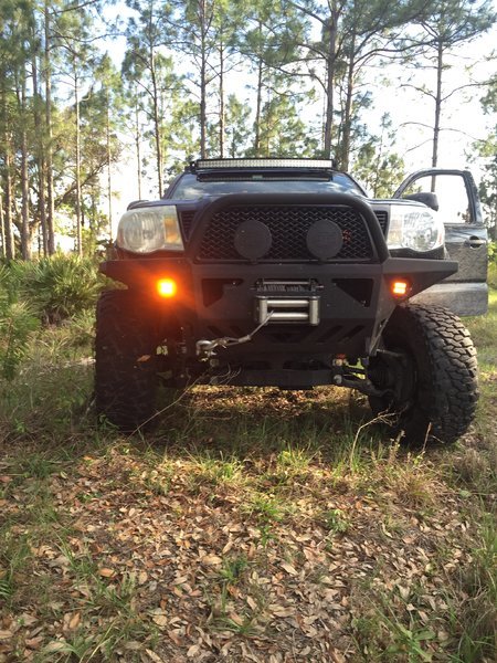

    I got the All-Pro front bumper and cut my fogs and just wired in the pods. Popped the fuse when I first turned them on but once I replaced the fuse I have had to issue.
