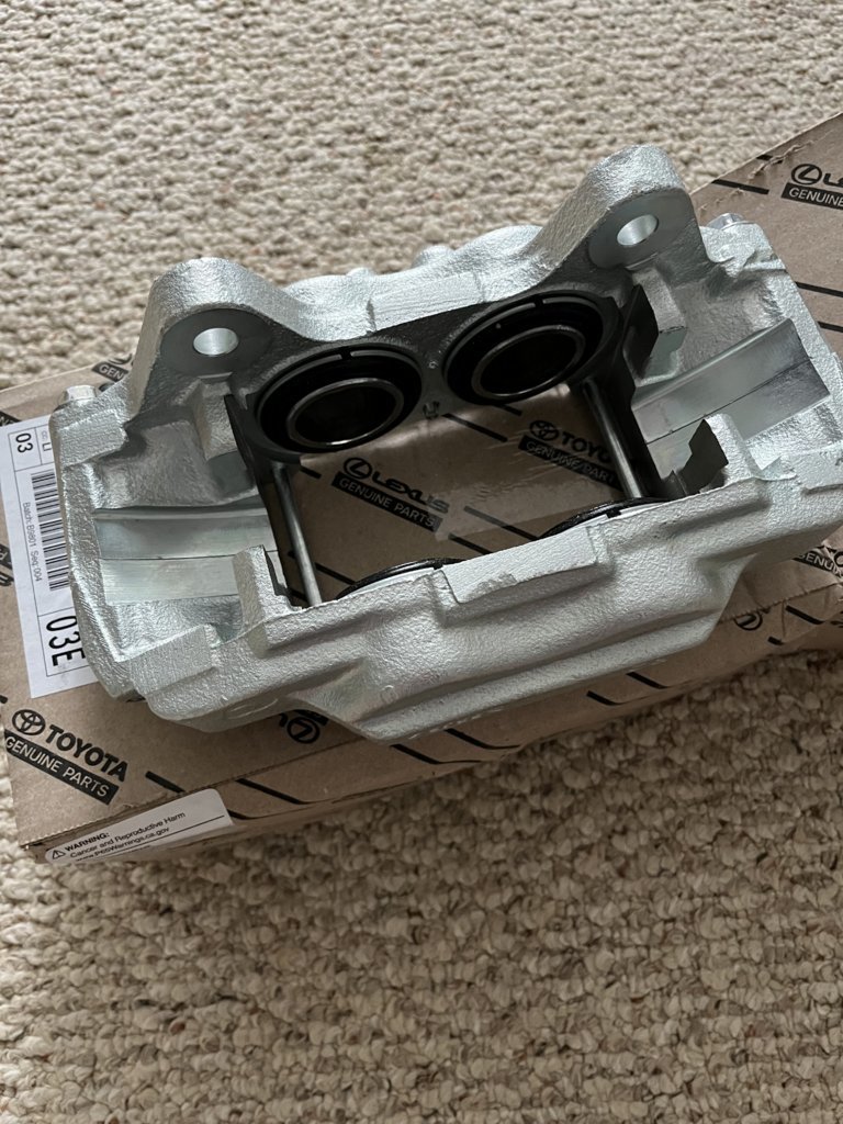

    IMG_9810.jpg I got my calipers from Toyota Parts Deal. They were $200ish each but I wanted factory Toyota. No regrets, pretty easy replacement job.
