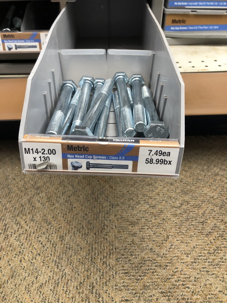

    Does anyone one know the OEM front diff mounting bolt size and bolt grade by any chance? I'm removing the spacers and was hoping I could find the correct size at my local ace hardware store, they actually have a decent bolt selection.

    A1246700-1D3B-4604-B7DF-B35C47D0FDA9.jpg A1246700-1D3B-4604-B7DF-B35C47D0FDA9.jpg Pulled one and subtracted the spacer thickeness. I found these at ace hardware and they fit perfectly.

    Make sure you get new nylon nuts and new washers as well
