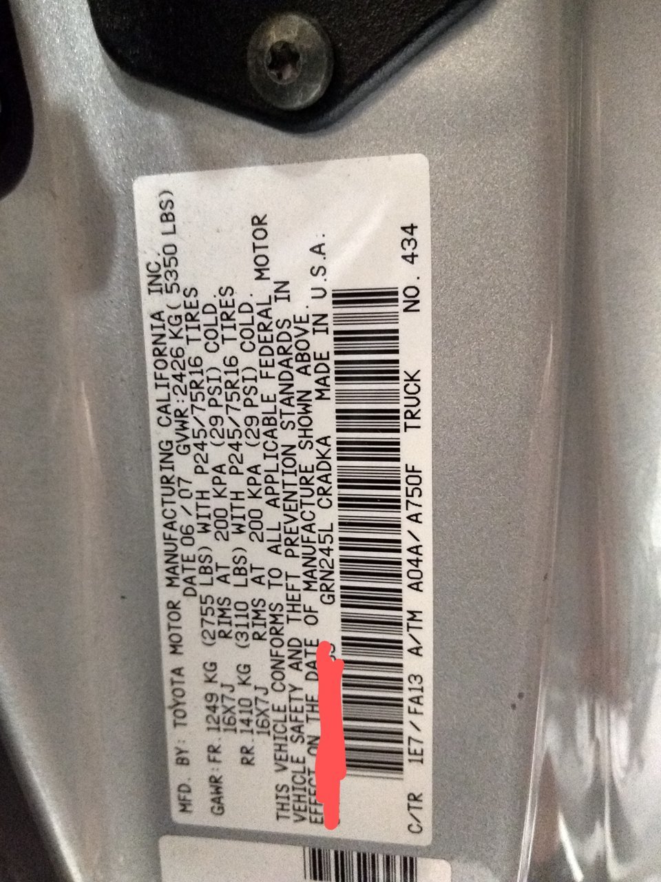

    my sticker says A04A which is a 4:56 ratio.

    I was reading a forum with the code info posted, but maybe I was in the wrong generation or something. Here is the picture of the sticker. I totally understand that the 4:56 wasn't available so I can't have it, but the numbers confuse me. She's some light please? Thanks !

    Is your truck a 4 or 6 cyl? 4 cyl have 4.10 from the factory and 6cyl have 3.73 from the factory.

    its a 6cyl. 2007. base model. i was seeing that the codes can mean different things for different gens.With Everyone being so sure its 3:73, i feel comfortable looking that up. thanks all!

    I just found this at Toyota Nation. 2nd. gen differential codes. 01= 3.583: 1....02= 4100:1....03= 3.153=1....04= 3.727:1....05= 3.307:1....06=4.300:1....& 07=3.909:1. Peee's me off, if changing the codes, don't use the same #'s for different ratios, change the #'s completely so they can't get confused, or better yet, leave them the same.
