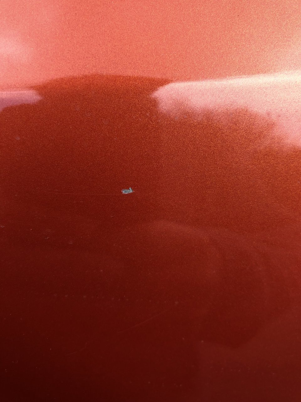

    Noticed a paint chip from a rock the other day. I’ll be modifying my stock flaps ASAP

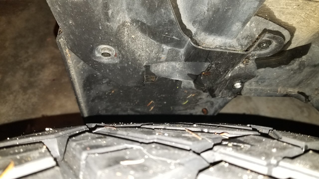

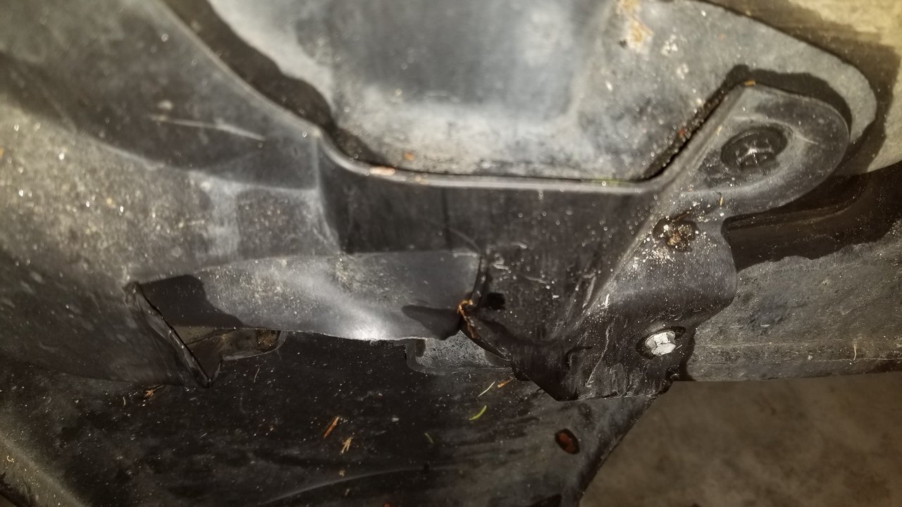

  12. Sep 29, 2020 at 5:39 AM
    #32
    Tacodelphia
    Tacodelphia Well-Known Member
    Aug 19, 2020
    #338182
    105
    David
    Philly
    2020 TRD OR MT Cement
    I put 17x7 et4 (4Runner TRD Pro) wheels with 265/70R17 (Falken Wildpeak A/T3W) tires on my OR with stock suspension. They only rub the mudflaps at about a 1/2 turn under braking or aggro reverse. I don’t plan any suspension mods, and I wanted to keep the OEM flaps.
    Rubbing was only on this little bump out, so I used a heat gun and some scrap steel to countour the bump to better follow the rest of the flap.
    This is the first smush. I probably hit each one flap with the heat gun 4 or 5 times to really smooth it out.
    Unmodified bump out.
    Modified bump out.
    I’ve only driven with these for about a day (trying hard to force some rubbing), so far it seems like problem solved.
    HaggisTaco and ll1l2l1l2lll like this.

    I have the same wheels and tires with the same rubbing. How has this been since you did that. I noticed there is quite bit of room behind the mudflap to really push thet portion back.
  14. Oct 5, 2020 at 9:45 PM
    #34
    Tacodelphia
    Aug 19, 2020
    #338182
    105
    David
    Philly
    98% good. I have rubbed like twice since i modified the flaps. The time i remember was coming into a parking lot hot (almost missed it), and the transition from street was pretty rough. I think it takes a fair amount of compression mid-turn—and it’s quite a minor rub.
