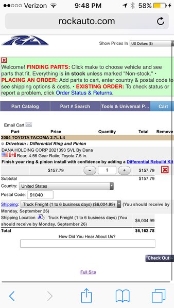

    I went to look at gears at Rock auto to change my 04 PreR 2.7 auto 2wd. I want 4.56s cause I want a little more balls but still want street ability. Here's the kicker the gear is 156 but check the shipping cost hahahaha
    Jimmyrace likes this.

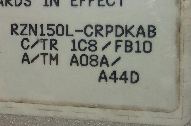

    2004 Tacoma Xtra Cab 2.4l 5 Lug Auto
    A whole lot
    Can anyone for sure tell me what A08A is?
    This is on my truck and I have no idea what's in it, this is weird.20161030_154439-2.jpg
