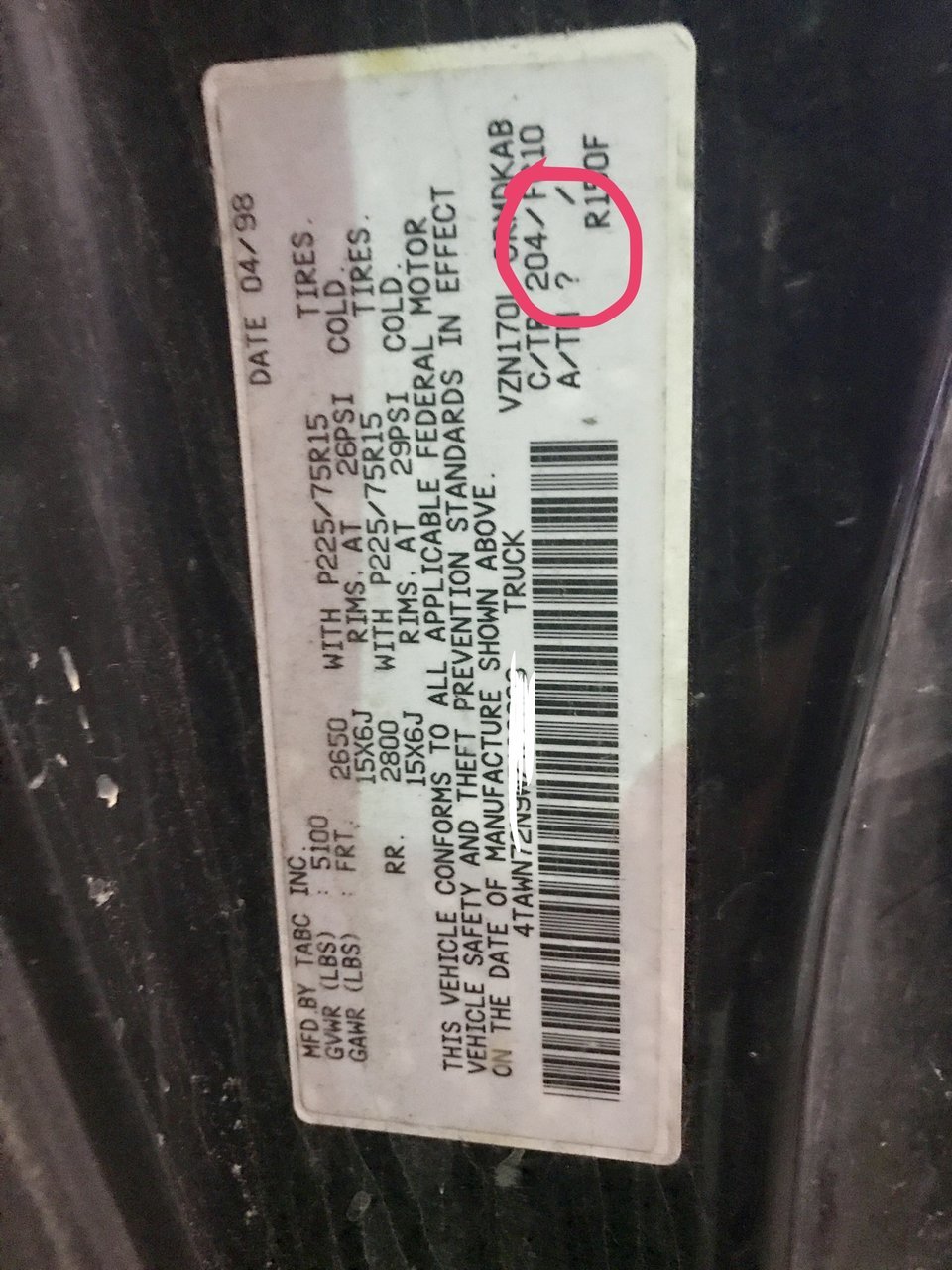

    Any chance does this chart work with a 15'? I seem that i can not find a second gen ratio chart. Im reading A04B. Hoping that I do have 4.56s with the 6speed for 33s

    I have B04A in a '01 2.7L extended cab (Auto) is this rare? Seems strange to have 4.56 in a 4 cylinder....
    Edit: Just read some more of this post and saw it's pretty common. Never mind I will see myself out. :)

    Just a heads up to everyone. When I sold all the drivetrain out of my truck I found a ? Where the gear code should be and all of my research shows if it has a ? Then it was a special ordered truck and you will literally have to figure out what headset you have by either guessing and counting turns. Or pulling the gear set out and finding out. I have a 5sp 3.4l Ex cab truck and turns out I had 4:10.

    Is there a gear ratio chart for the 2005 and newer Tacoma's? I don't believe this chart applies to 05 and newer. My 05 Tacoma TRD w/Elocker read's A04B which would be 7.5 Ring Gear 4:56 Gear Ratio, 4 Pinion Open diff, but according to Toyota with a vin search it has 3:73. Any info would be appreciated.

    They have a different code chart. I've tried to fine one but no luck.
