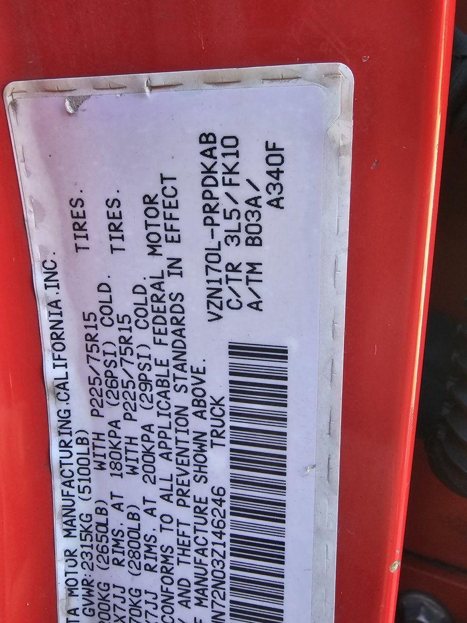

  9. Sep 15, 2023 at 5:02 PM
    #129
    Tline155
    Tline155 Member
    Sep 12, 2023
    #433384
    14
    2003 Red Tacoma TRD
    Am I looking at B03A?
  10. Sep 15, 2023 at 6:23 PM
    #130
    19975lugger
    19975lugger Hand-me-down
    May 7, 2023
    #424160
    149
    Southern California
    1997 5 lug LX
    Fabtech 3" spindle lift kit with add-a-leaf and shocks. Borla exhaust. K&N cold air intake. American racing wheels.
    yep
