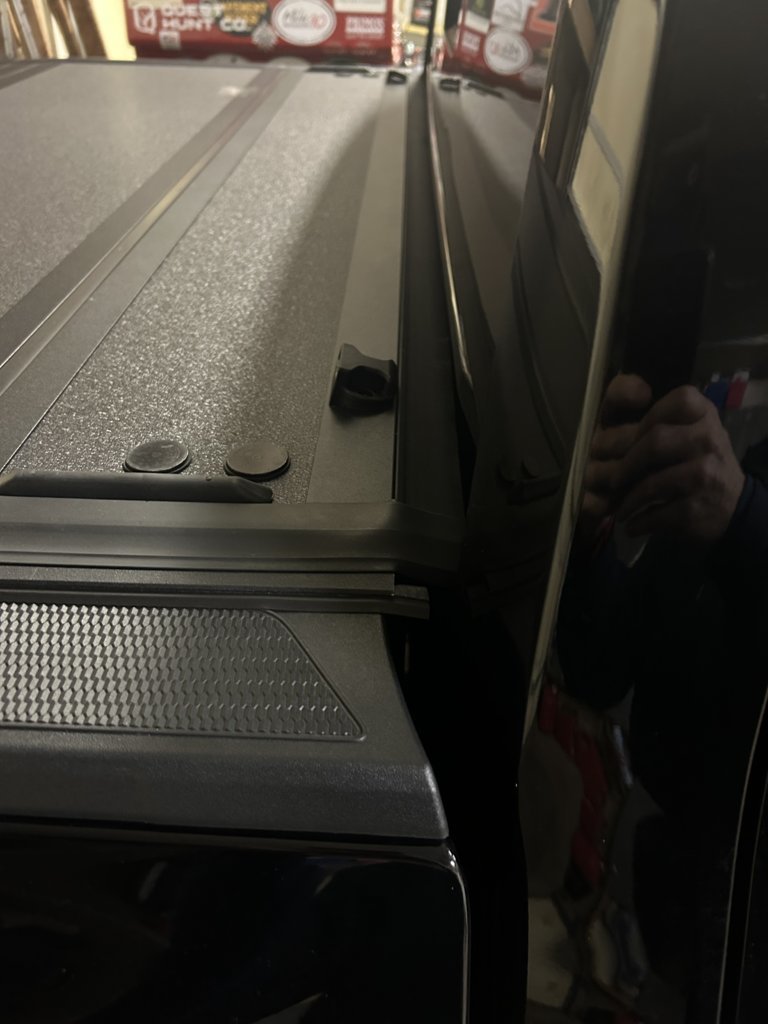

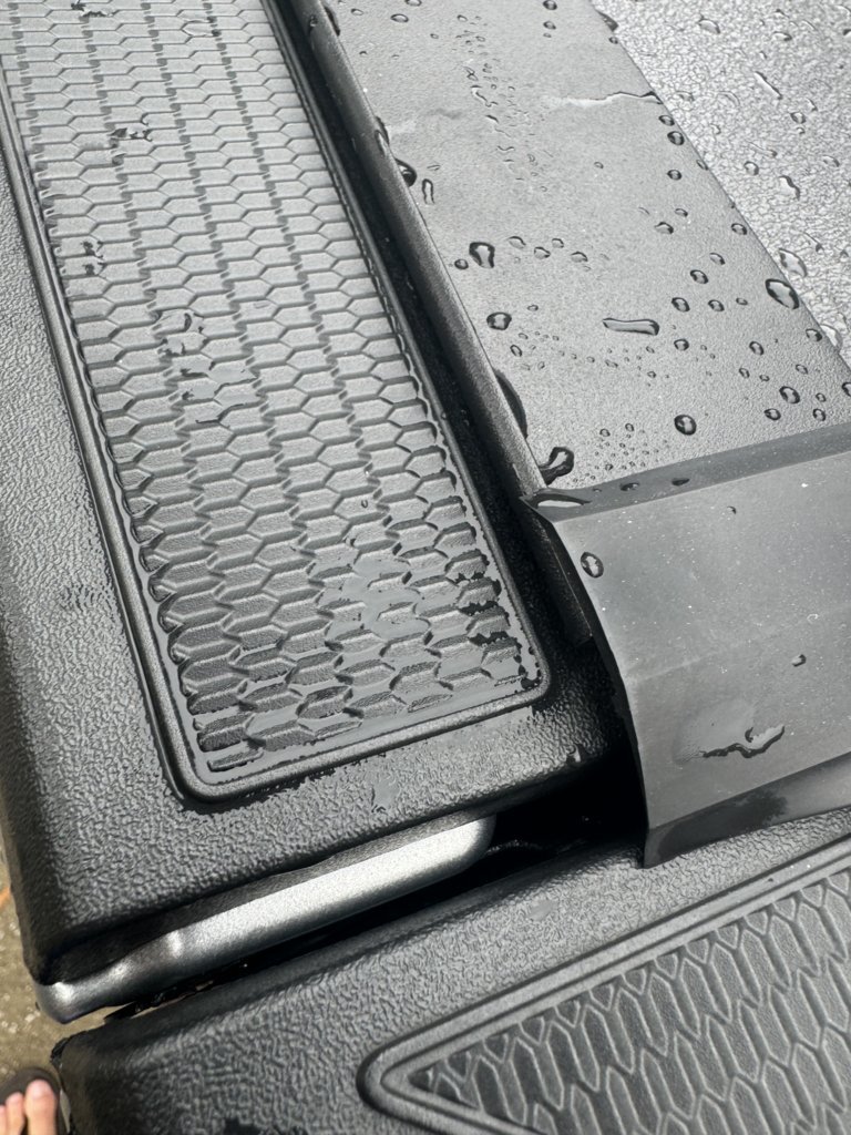

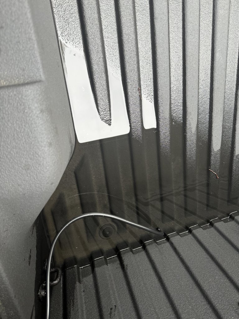

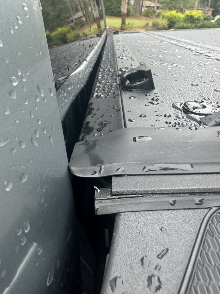

    Had the first rain after dealer install and the bed has a fairly large puddle in it.
    looking at the cover, the only gap i see is at the back where the cover meets the tailgate.
    Looking at the front where the cover meets the cab, it seems it was installed too far forward.
    Does anyone have experience or suggestions before i take it back?

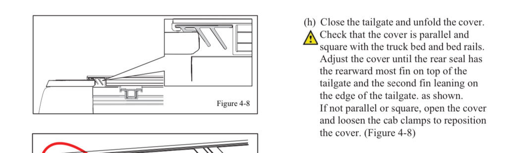

    Looking underneath the cover, i see two clamps on each side closest to the cab. Each secured with two bolts-4 total. I assume this is as easy as loosening each a sliding the cover towards the tailgate?

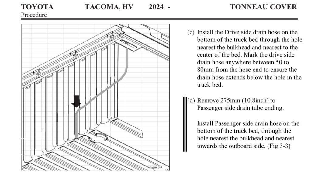

    You can pull the tubes so they drain into the bed. That will still allow them and any other moisture to drain out the existing drain holes. I did that to mine and just tucked the end of hose under the bed mat.

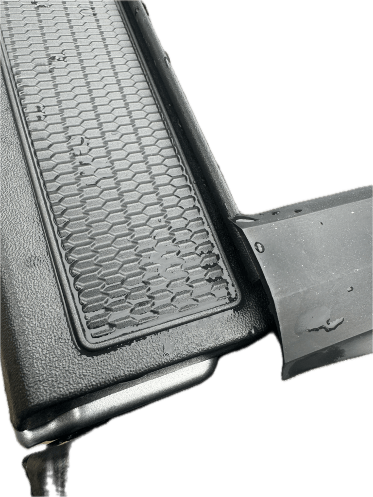

    Thanks for the reply and idea. Does your cover overhang in the front as much as mine in the third pic? I am still thinking it was mounted too far forward.

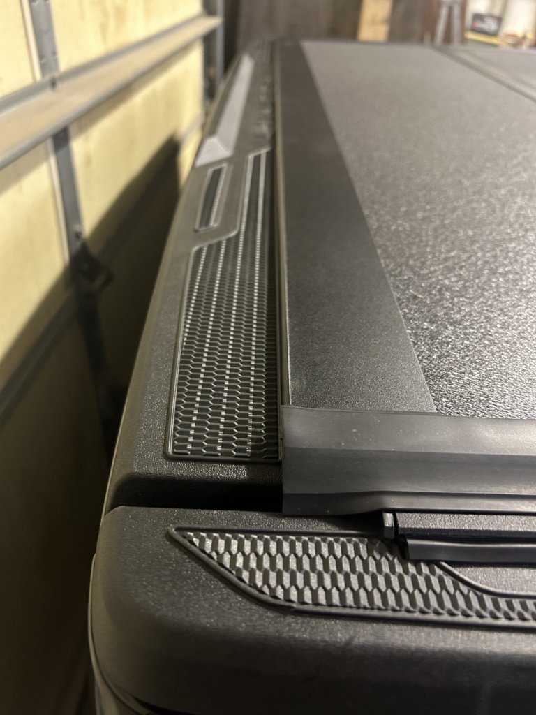

    Pics of front and rear placement

    Forward is good because when it’s flipped up it stays close to back window. Also gives the most room when in that position.

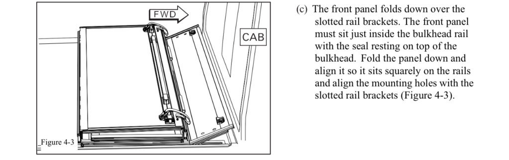

    According to the instructions that is too far forward. You can easily adjust backwards by loosening the 4 nuts and sliding it to the rear then tighten nuts. You may need to remove the cotter pins to do so.

    I installed this cover myself and I carefully read all the instructions. It looks like this one was installed without care.
    Couple things to consider:
    1) Most importantly, that cover looks too far forward.
    2) Those tubes could be pushed down further, but that’s not the cause of the leak.
    3) If you could, take a pic of the side rail where the rubber seal sits on the bed cap. I’d be interested to see if they aligned it like I did. There’s a small lip on the hard plastic that could cause the rubber seal to be raised. Either way, the channel should’ve directed the water to the drain tubes.

    On the subject of water. Is it just me or does the drain hole placement in these trucks make no sense? I think we have 3 holes in the bed. The hoses end up covering 2. This won't allow sitting water like the OP has to drain. Can new holes be drilled?

    I thought this initially as well. It's like the tubes should run straight down through new holes.
