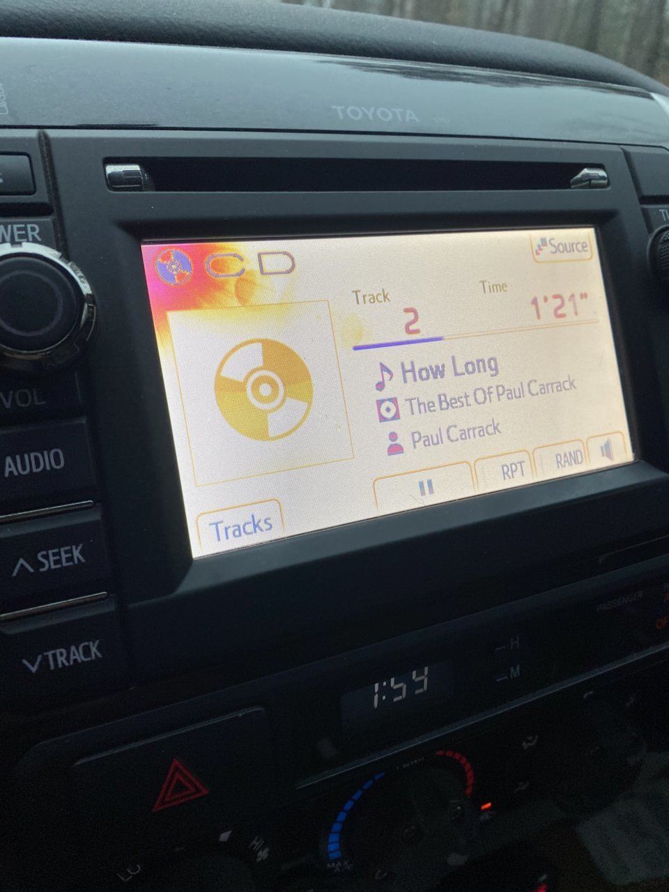

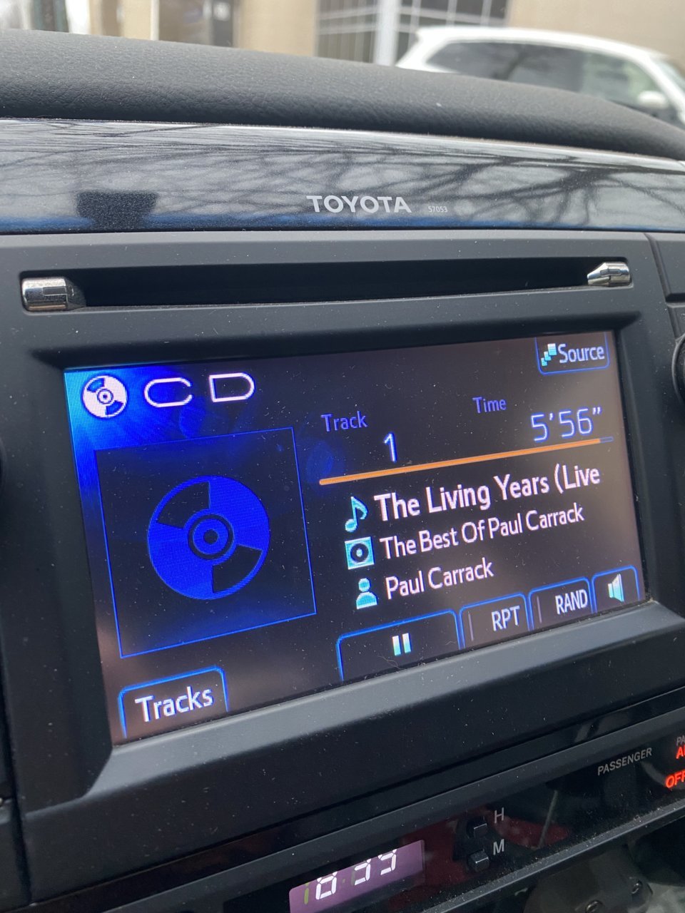

    D3ABE56C-EFD8-499A-ABB7-FFD6C1A6CA67.jpg 3B259B0D-7F24-4368-93AF-72D545CA42D7.jpg So this just started my screen is white for about 10 min. It was 55 degrees and foggy this morning. But I have seen it happen in the summer also.but now it happens every start up.

    Mine does the same thing on occasion. Actually I even made a post about it awhile back. What I have found to work is to turn the screen off through the settings menu and then back on. Everything went back to normal. Then when it does it again weeks or months down the road, I just repeat the process. Sadly, as stated above headunits don’t last forever. I’m beginning to look for a replacement, but it needs to support my factory backup camera and a few other features.

    I play everything Paul just happened to be on when I took the pictures don't be a hater :facepalm:

    Probably need a new screen, there have been several posts on here about replacement of these screen with instructions on how to do it, around $125. My take go find a pic a part place and buy a replacement one but stay away from any of the 2017-19 radios as they do plug in but are too wide and high to fit without heavy modifications to the face plate.
