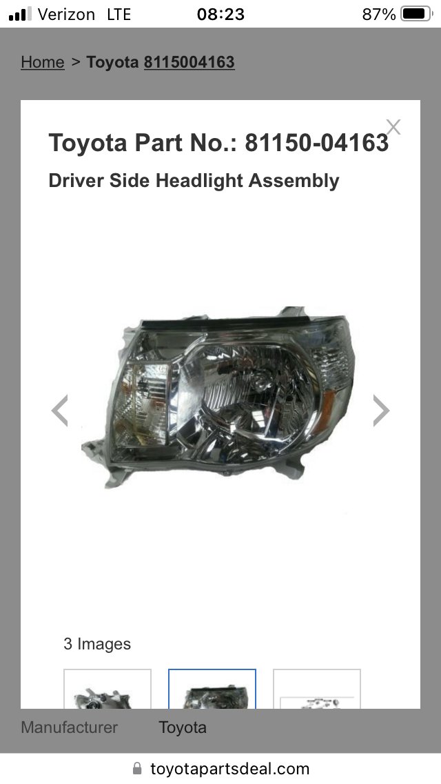

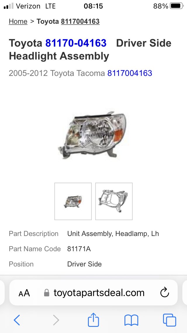

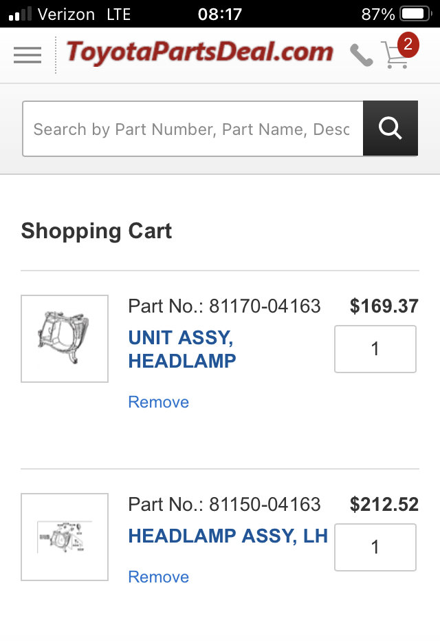

    Shopping for new OEM headlights. Can anyone tell me the difference between these two part #s? There’s a @$45 difference on this website and reading and looking multiple places online I can’t find what’s different other than one may be slightly tinted. Thanks!

    Neither of these P/Ns are tinted (smoked). Instead, the P/N difference is the cheaper one comes w/o bulbs, while the more expensive one comes w/bulbs.

    One more thing to add. In case you have DRLs and want the latest & greatest P/Ns that don't have the melting issue, check out T-SB-0129-11. In there you'll also find the P/Ns for the smoked (tinted) headlights in case you need/want those instead.
