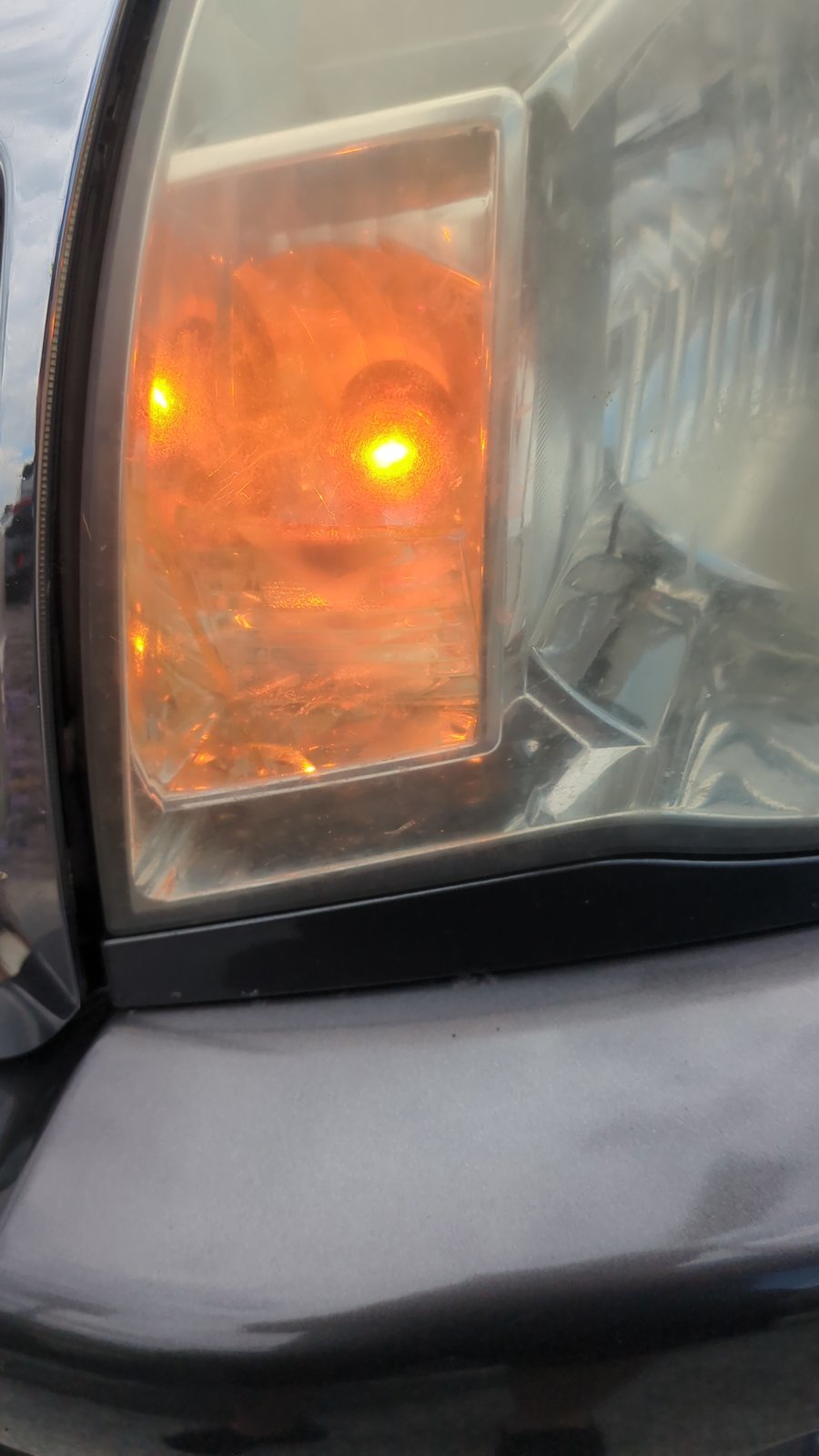

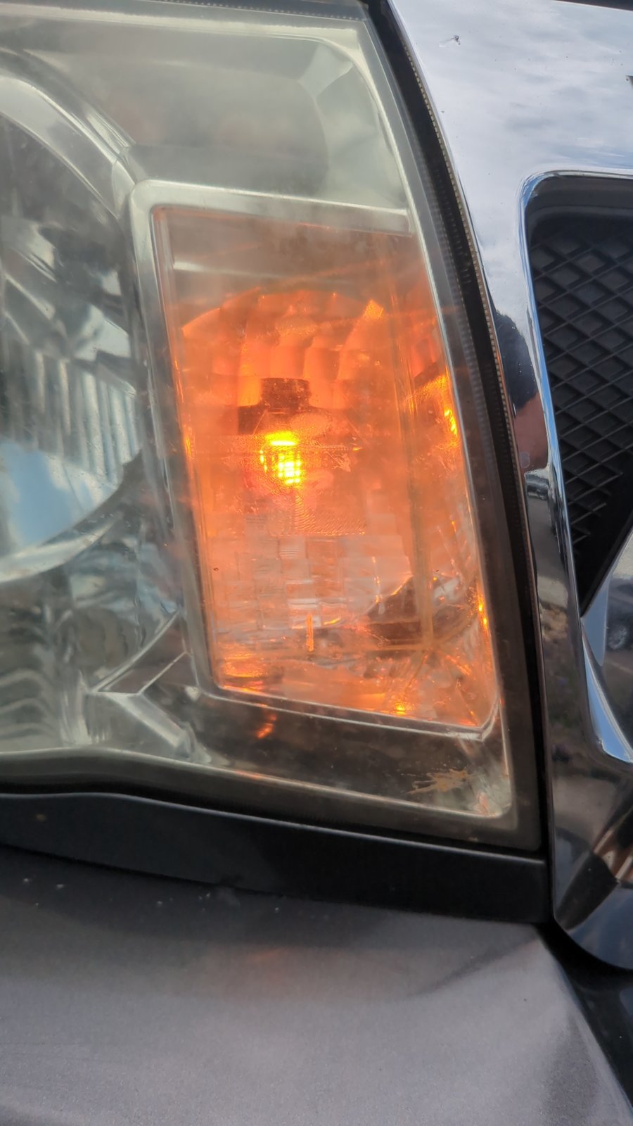

    I have the melting ( I think) see the pic. But I'm sure I don't have DRL.
  5. Jun 24, 2024 at 1:51 PM
    #25
    Tiedie
    Tiedie The Only Shantytown Resident.
    Jun 28, 2011
    #58973
    5,759
    David
    WFOY
    Katzkin, Dobinsons full suspension. Redlinegoods console cover and door panel arm rests, Double USB charger in dash installed, Ballistic Jesters 16x8. BlackVue DR 590 Dash Cam
    Yes that's it but it's not too bad. When you start truck and put in 1st. or drive do your turnsignal lights come on? It's hard to tell do you have a bulb in there?

    It's in park right now and the yellow/ orange bulb is on

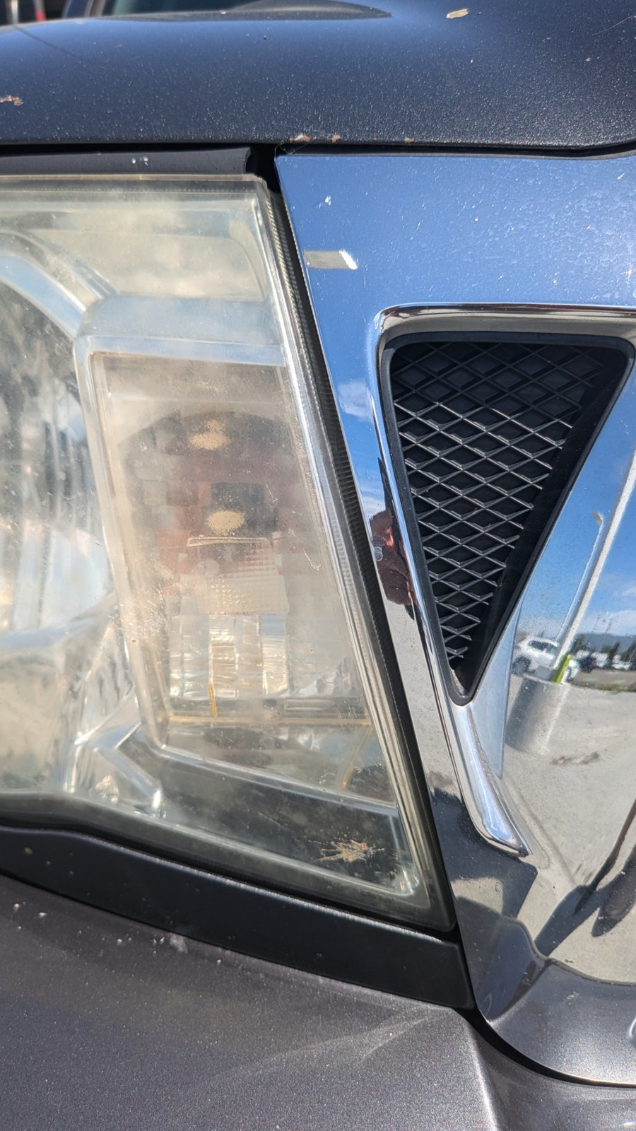

    That was right side, this one is left
  8. Jun 24, 2024 at 2:14 PM
    #28
    tacokhan
    tacokhan [OP] Well-Known Member
    Feb 25, 2012
    #73563
    61
    On the right side it looks like the glass in front of bulb is broken. I'm really undecided to buy the original one from local dealer or the improved one from those sites others mentioned

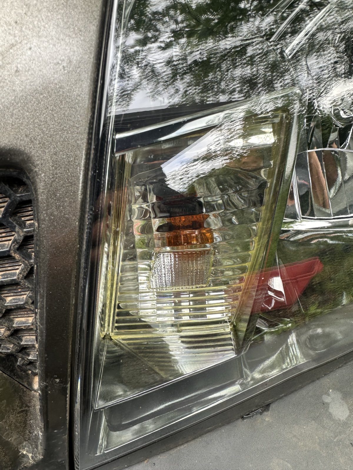

    OEM smoked... (came on the 09-2011 Sport but will fit the 2005-2011 Sport and Offroad. Got them online from Boch Toyota South... OEM part# 81150-04173 / 81110-14173. Tried numerous sites to get the tsb versions... all out of stock/ quit making. These are non tsb... the dtrl lens are clear compared to the old faded yellow. Wondering if after the tsb ended they updated the old part numbers with new non melting lens? Time will tell.

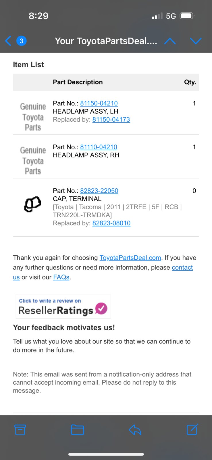

    I posted my issue in the ultimate headlight thread as I recently did that upgrade with new oem smoked headlights. I didn’t realize it at first but my driver side lamp appears to be a non tsb older version while the passenger side lamp is the updated tsb type. Here is my invoice showing the parts I ordered. I’m not really sure what do
