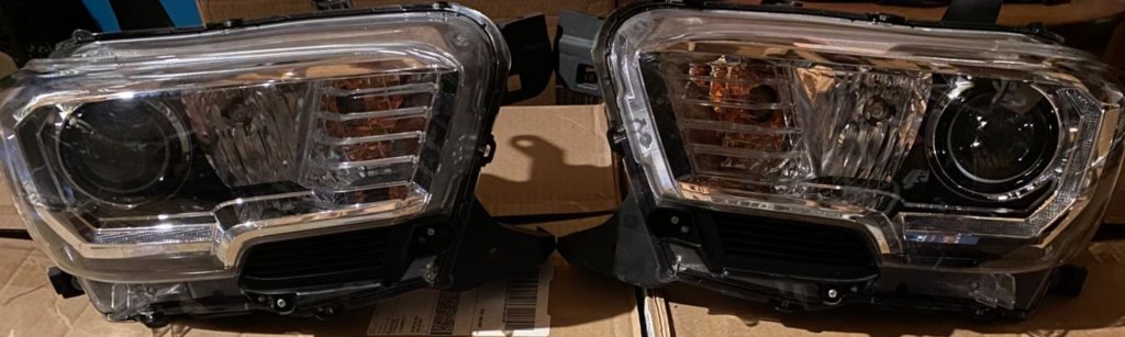

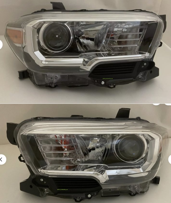

    Reading through some research, the 2016-18 TRD Sport did not have the LEDs that came with the 2020+ TRD Sport.
    2016-2018 OEM Halogen Headlights:
    2021 TRD Sport OEM Halogen/LED Headlights:
    You'll need a Harness for the correct connection. Paging @daveeasa

    I made the conversion last year, bought my harness from Dave - daveeasa.
    I chose the Pro version of the LED headlights, for less chrome.
    81110-04300 - TRD Pro RH
    81150-04300 - TRD Pro LH
    The light output is significantly improved.

    The OEM Halogen/LED-DRLs on my 2021 TRD Sport before I installed full OEM LED Headlights: (In case you don't want to spend on full LEDs)
