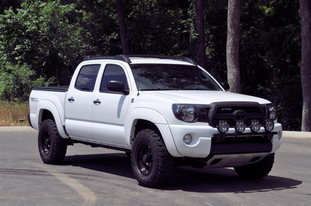

    I was wondering if there was a way to the Headlight of a 2013 black...thanks

    Look up BHLM
    Black HeadLight Mod

    damm it looks hard to do :/

    Not hard. Just a little time and your'e good.

    Some people pick up a spare set of headlights just in case they mess up their other set attempting it.

    Seems daunting but in reality, if you follow the instructions and take your time it's one of the simplest mods you'll do.

    It's not hard just intimidating the first time. I've been doing it since 2005 and the hardest part is convincing yourself to put them in the oven.
    First set I did
    Last set that I did
    The only real hard part (aside from putting them in the oven) is pulling the lens off the housing. You have approx. 1 min. to get it off. Everything after that is simple. Pull the bezel out, prep, paint, put it back in, and reseal the light.

    wow they look great!!
