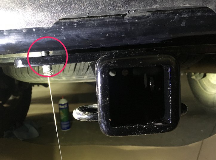

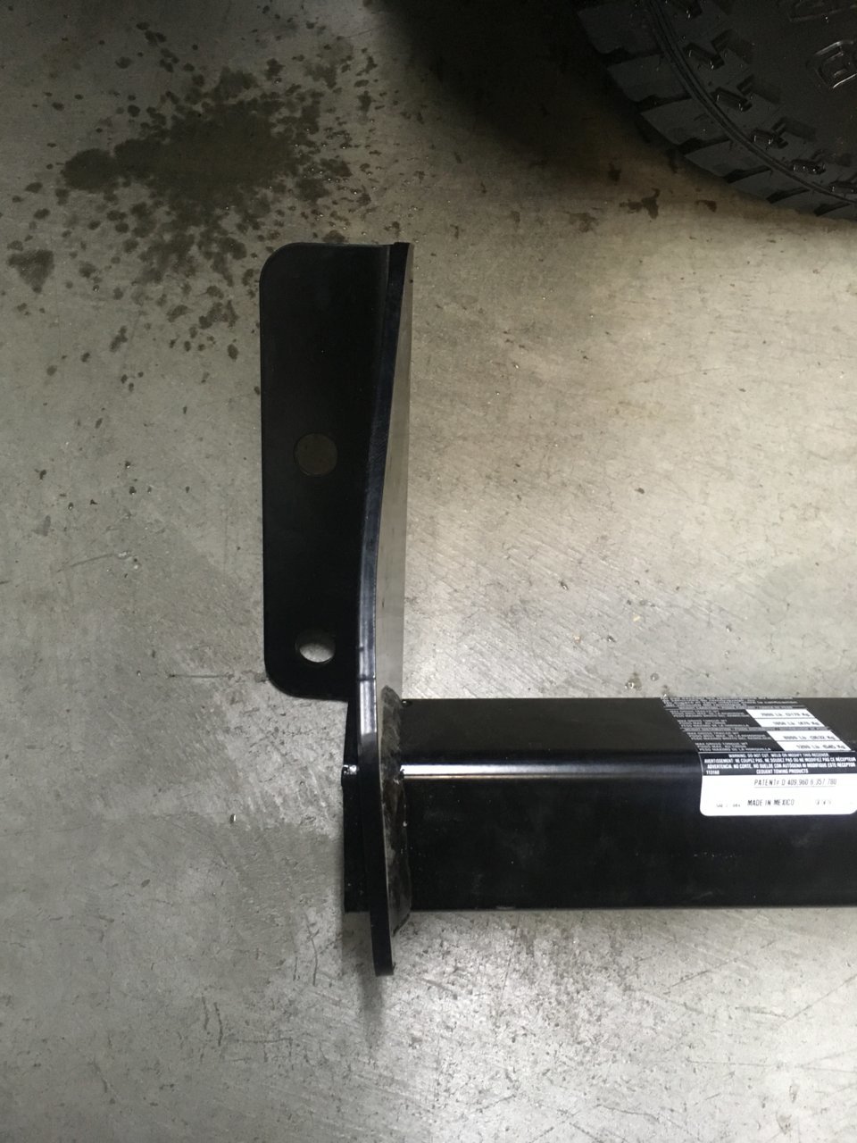

    So i've now ordered 2 drawtite hitches, neither of which worked on my truck. The first one had a gap in the area between the ball and the bottom of the frame, and the gap prevented me from attaching the nuts to bolts. See the photos. The 2nd one just got here this week and when I went to install it, I noticed one of the side pieces was complete crooked and welded incorrectly...at least that's how it looks. Guess I'll return it and buy the curt! What a process/mess this has turned into.

    Wow! You can try uhaul and see if those are better. You night be able to pick up an OEM hitch either on the Buy|Sell|Trade (https://www.tacomaworld.com/forums/3rd-gen-tacoma-parts-marketplace-2016.202/) thread here or maybe at a junk yard.

    The Tacoma frame is tapered you would have huge gaps if they welded them a 90 degrees to the hutch tube.
