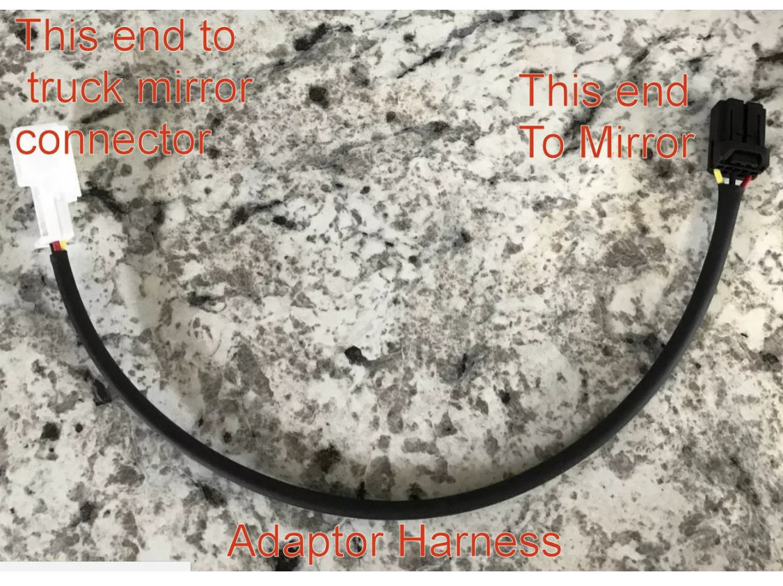

    @Squirrel13 OP, this is a very simple solution. Get in touch with Rob. He specializes on homelink mirrors and he sells a plug and play harness that will only works if the truck is on.
    I bought the same harness from him a couple moth ago and I am very happy with it.
    Thanks again Rob!:thumbsup: @RJP869

    Just thought I'd chime in on the subject of Homelink being operable at all times versus only with the ignition on. I've been dealing in mirrors for over 20 years, even before Homelink was an option on mirrors. Even before then, when vehicles had HL in the overhead console or on the sun visor, it was, and still is, common practice to have it so that HL is operable at all times. Only a few carmakers have Homelink be operable when the ignition is on, such as Subaru vehicles, but the majority still make it operable whether or not the ignition is on. And yes...we do have harnesses available for many of the Homelink mirrors that make it so that HL will only work with the ignition on instead of always...we've gotten a decent amount of requests over the years for them, so we are able to make them up for a variety of mirrors.
