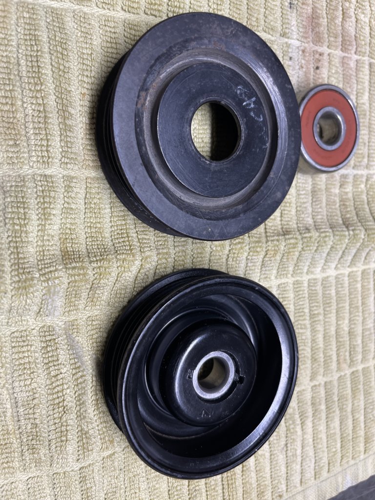

    All of the research that I did says the Ac idler pulley and the power steering idler pulley are the same. And I was going to just change the bearings in the pulleys but after removing both the original Toyota pulleys, it looks like it is not feasible to press out the bearings in the power steering pulley.

    I think you are correct. You can interchange the AC idler pulley with the power steering idler pulley, even though they are not the same part number. I am not talking about buying a new pulley. I am talking about pressing out the old bearing and installing a new bearing. You can do that easily on the AC pulley, but not on the OEM power steering idler pulley because they are totally different

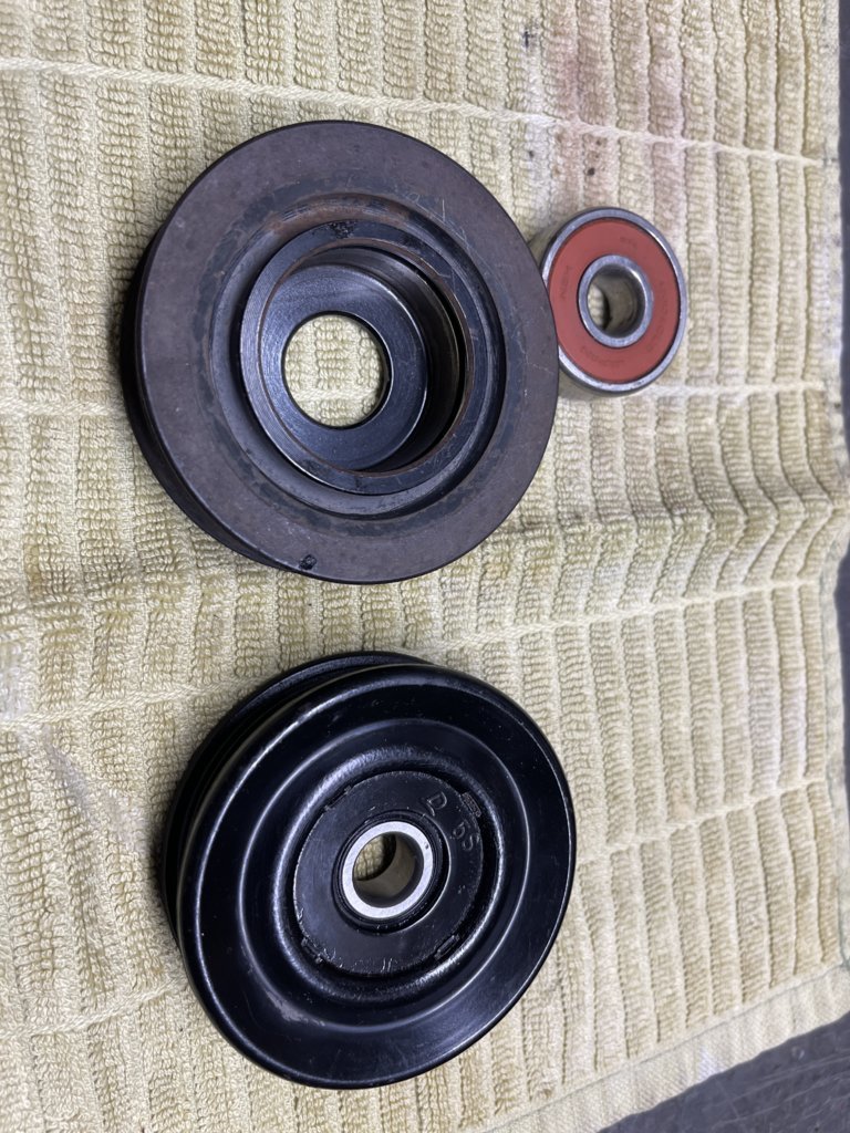

    The difference is not the center bolt that I can see. What I can see is the difference is - the AC pulley , you can press out the bearing and press in a new bearing but if you look at the two pulleys, the power steering pulley is designed so there’s no way to press out the bearing. The pulley on the right is the power steering pulley and the pulley on the left is the AC pulley as you can see they are totally different. These are OEM pulleys.

    I just took those OEM idler pulley’s off of my 1998 reg cab 2.4L truck. The one on the left I have already pressed out the bearing, but the one on the right as you can see, which is the power steering pulley. It’s totally enclosed. There’s no way to press it out on either side. Now if you have an aftermarket pulley such as the gates, then it is open on one side and you can press out the bearing and press on a new one, but not on the OEM pulley

    Yes, I understand what you’re saying but I don’t think you understand what I am saying. I am saying you can’t take the OEM Toyota power steering idler pulley and just replace the bearings in it because it’s not possible to just replace the bearings in that pulley. Yes, I understand that you can buy aftermarket pulleys, that fit in that application, a lot less than Purchasing the OEM Toyota idler pulley assembly. By the way, did you know the Gates idler pulley is made in Canada and that is correct. The pulley is made in Canada, but the bearings that are in it are made in China.
