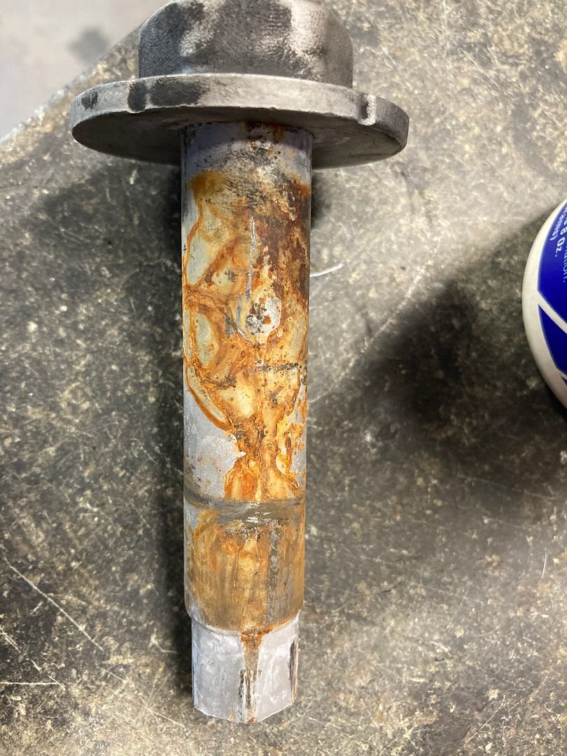

    Too Stroked
    Too Stroked Well-Known Member
    Jan 24, 2017
    #208501
    3,912
    Tom
    South shore of Lake Ontario
    2021 4Runner SR5 Premium
    Just to give you an idea how quickly the OEM bolts start to corrode in an area where road salt is used, here's one out of my 2021 4Runner after only 3 months / one winter. Why did we pull it - and all of the others - out? To apply a liberal coating of Never Seize to the shank area that rides inside the bushing in the LCA. No aftermarket rustproofing is going to reach this critical area. And yes, after we put everything back together, it was off to the alignment shop.
