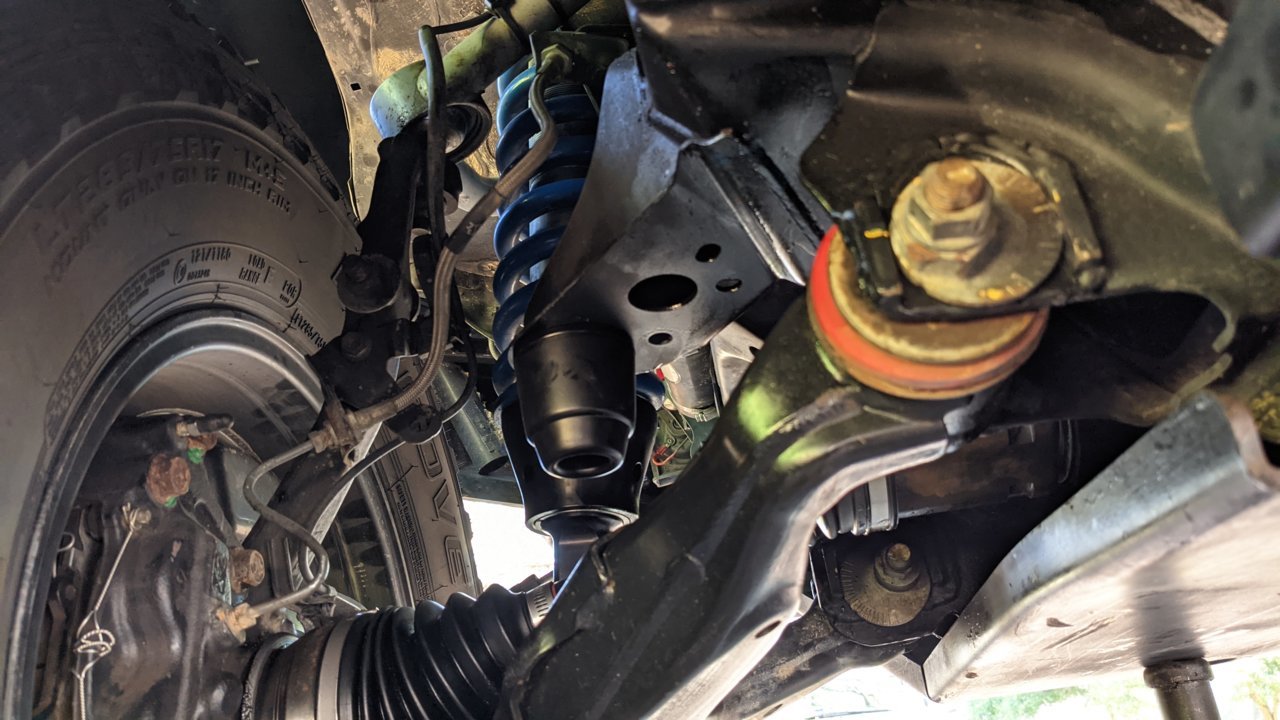

    The OEM lowers are already really pretty strong typically the reason for going aftermarket at stock length isn't for strength but is to get a uniball for the lower ball joint, to have provisions for a dual shock setup or a jounce shock or hydro/air bump, longer shocks and or limiting straps. Also because they're rebuildable as you "can't" get lower ball joints for the OEM. (You can through Ebay from the UAE just not U.S. dealers.)
    You could get lower control arm armor if you're that worried about them but I don't think boxing is necessary, you're going to bend your spindles long before you break a control arm.

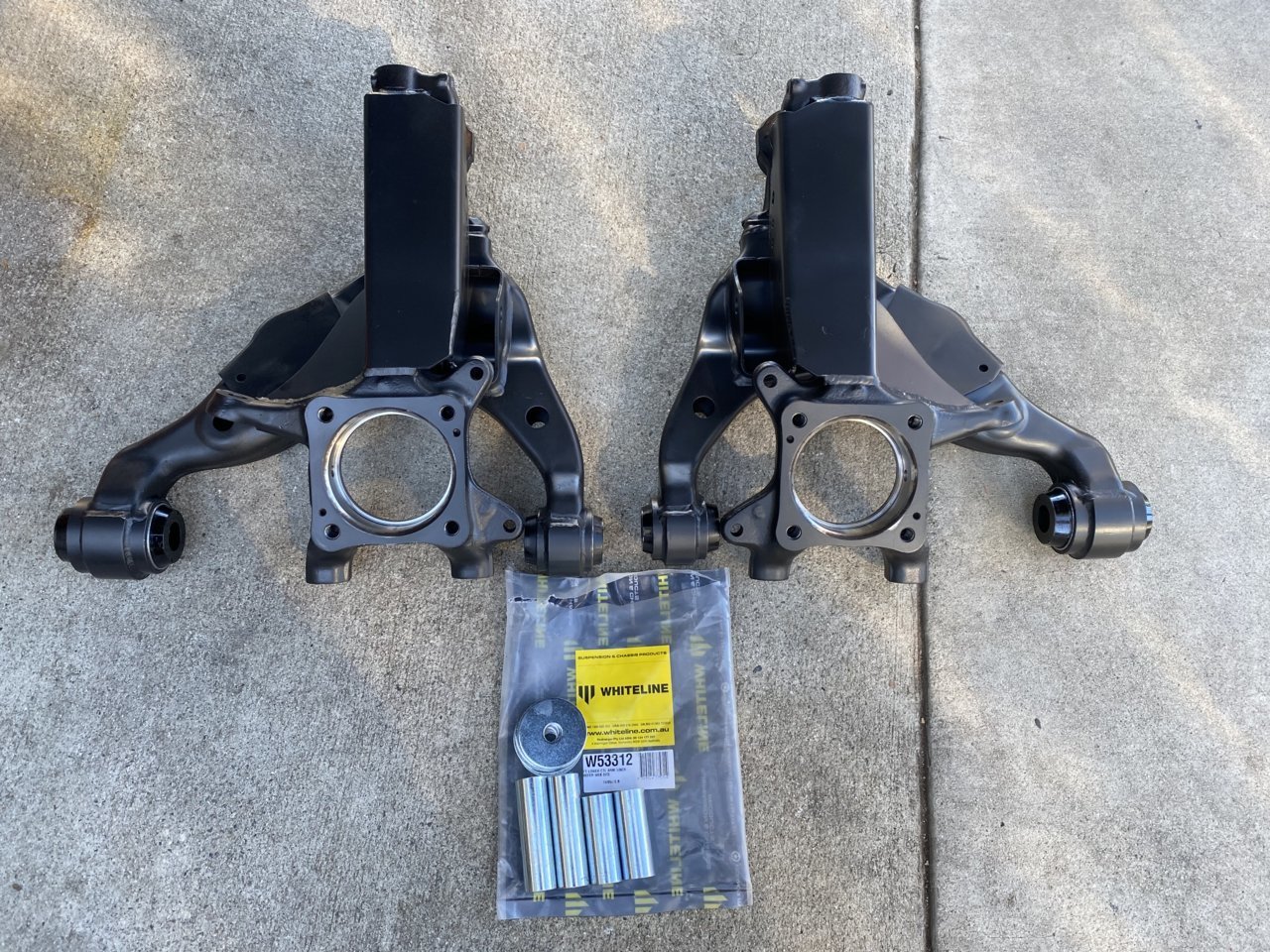

    Thanks for your insight that makes me feel better about going with some new oems. Im also running a spindle with the total chaos gusset kit on it as it wasn’t much more than a new oem set. I also want to do king bumps all the way around as well pretty soon.

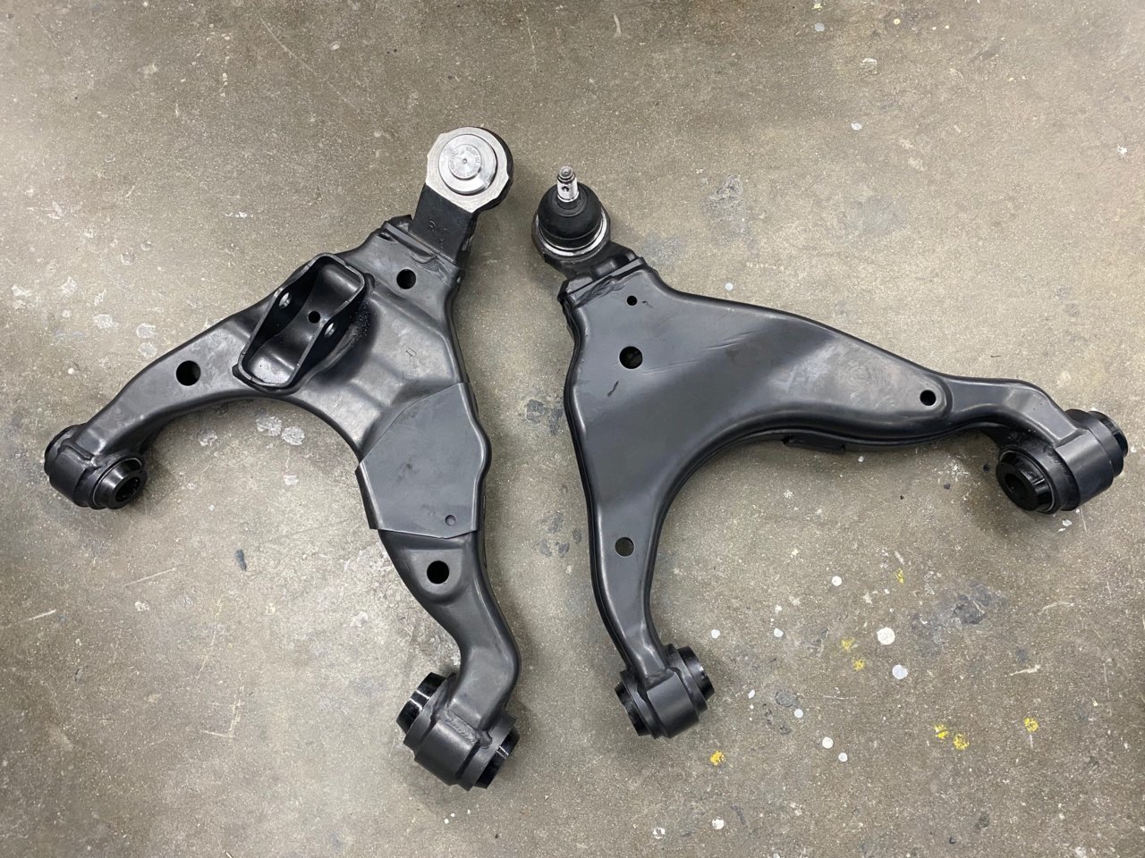

    If you're buying full on new oems at off the street price, then you're already most of the way price wise to get in something like a stock length total chaos lower control arm. Might be worth it to you considering you are planning to go overboard to get those instead.

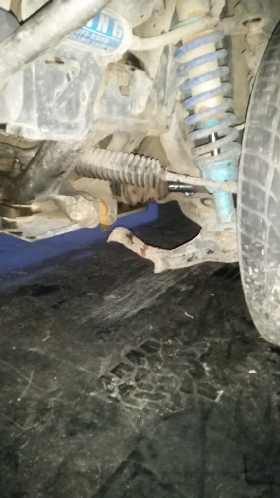

    @Dpher I put on some Total Chaos stock LCA armor.
    I like the look of all the armor :rolleyes:
    Have had them for years, powder coated at one point. Re-painted with spray many times. Sand blast em each time I redo em, seems to help a ton with the spray paint adherence.

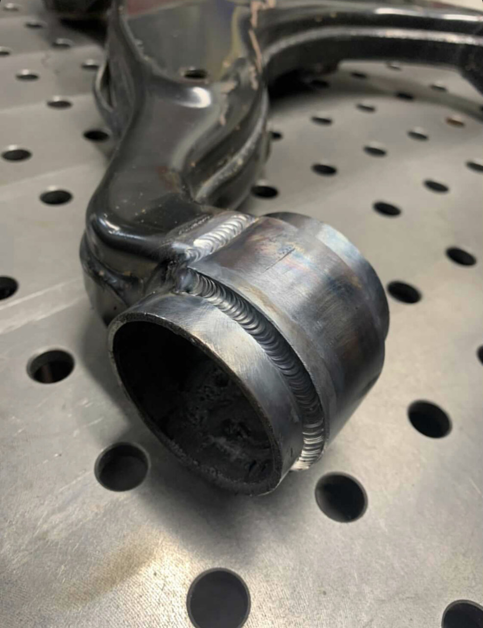

    I had my stock arms reinforced when I rebuilt my front end. The main reason was that I've seen failures where the tube splits and the arms comes free from the bushing. It may be very rare but it was worth the peace of mind. I also added the rci lca skids later for further protection.

    This is what I'm talking about

    Those look really clean I think im going to brace mine up like that and probably just rebuild my stock lca. Eventually I just want to go full lt but thats out of the budget for a few months.

    Look at the coloring of the breakage point, and the rest of the frame, it's a dead giveaway that the cause of that failure wasn't the design of the lower control arm but corrosion. Rust is going to damage anything and that looks like a truck that's seen salt roads.
    Part of preventative maintenance is corrosion inspection, after every wheeling trip I pressure wash the crap out of the undercarriage after it dries I do a thorough inspection for damage, anything loose, and most importantly: corrosion! Including checking into the weep holes on the A arms and inspection points in the frame.

    This has happened to many trucks on the west coast as well. Tube has a seam on it from the factory, it's not solid round.
