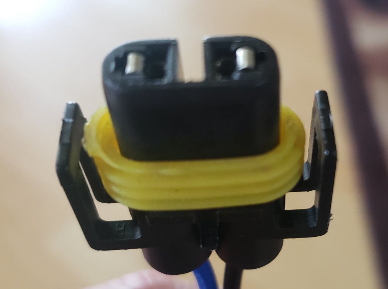

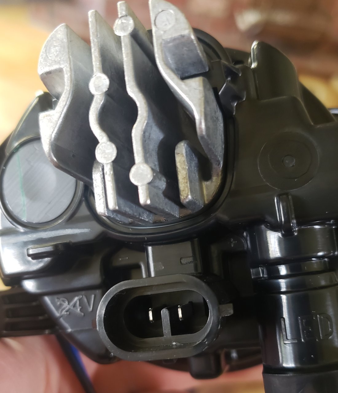

    I ordered a set from a dealership brand new. When I installed them, they do not turn on. When I tried a second set of halogen fogs, they light up. Are those LEDs defective? I thought they were just plug and play. Any way I can test the LEDs? Any help would be appreciated.

    Polarity issue maybe?

    I would try reversing polarity. Halogens don't care about polarity, LEDs usually do.

    I can only plug the harness in one way.

    It was reversed. I just cut the female off and reattached in reverse so it would fit. Thanks for the help.
