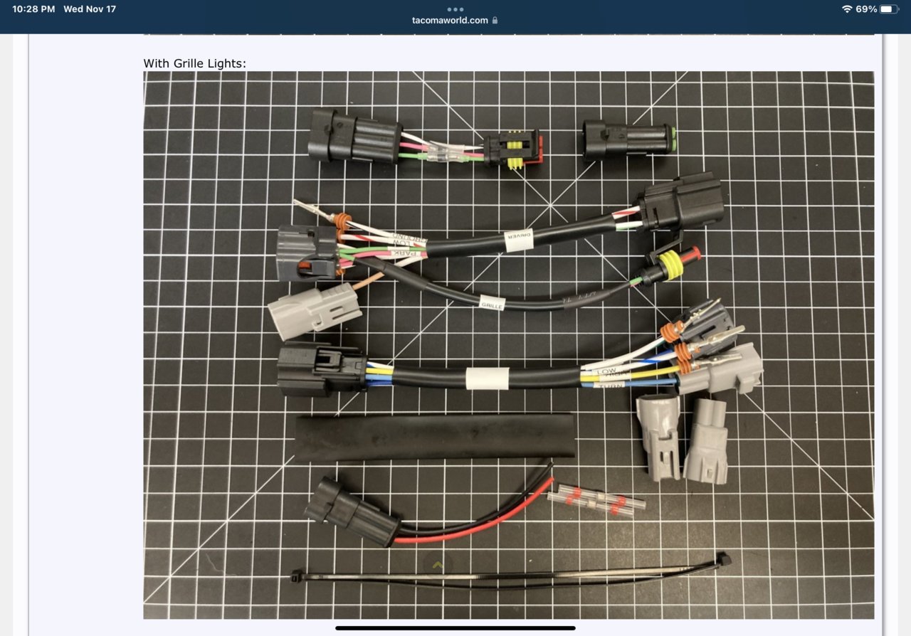

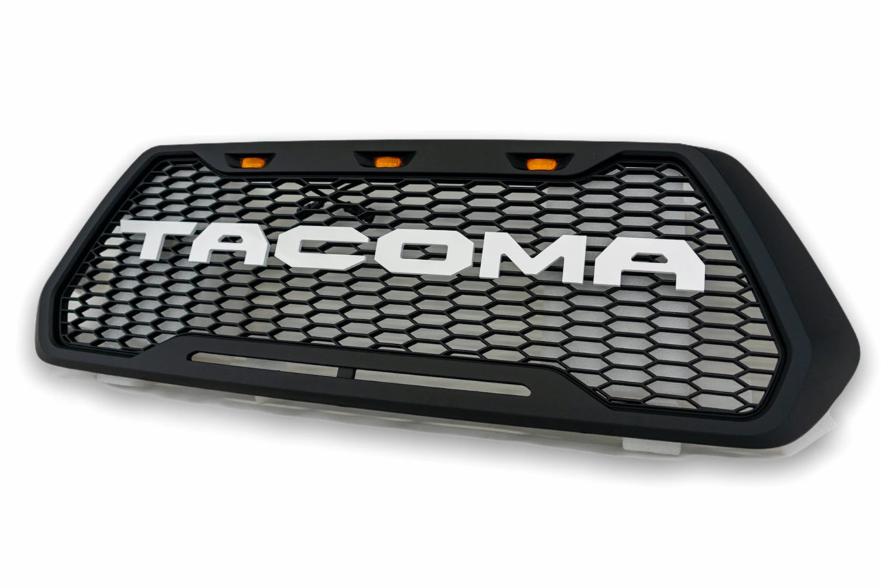

    Hello,
    Thank you for your reply.
    This is the grille and raptor lights I plan to add along with the OEM LED headlamps. For this setup what harness do I need? Do you have a part number I need to ask for? Or, what verbiage do I need to say? I want to order the harness so that I have it for when I get the grille and headlamps. There’s about 4 weeks lead time for them. The last pic, is that the harness needed?
    Thanks again,

    Yep, that’s the one. Pick headlight harness with grille lights and you are all set.
