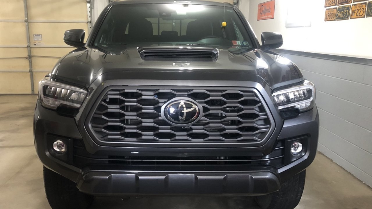

    Dave’s harness is the cats ass, great quality. I did manage to break one blue clip and he has us covered for that too. Thanks Dave, happy camper here. FA3169D1-7E67-42A3-8998-982632E9A323.jpg

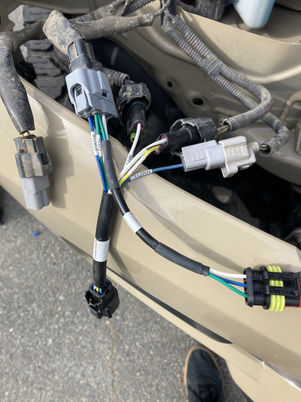

    OK, so, I have made some adjustments to the OEM LED headlight conversion harness options. Now available in extra long 12" for people with compressors or dual batteries who want more length. And a double DRL/Park output option for SS3 fog light backlight plug and play. Same basic thing just a few more options for customization to your liking.

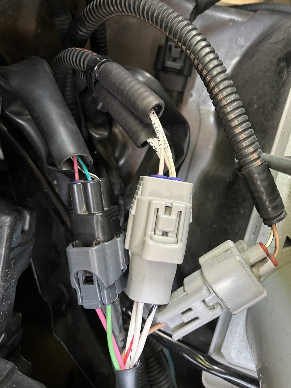

    Yesterday I switched my high and low beam connectors on my Tacoma to use a 4 way Sumitomo connector. I wanted to understand the level of effort involved with crimping OEM wires directly on the truck without removing any parts. It is definitely doable but it took me over an hour. Granted I didn’t rush, I added some heat shrink labels to each wire, and I tried to make it look as clean as I could. But I’m also fairly well trained on crimping and I know my wire colors well, and I have all the tools, parts and supplies handy.
    In hindsight, this wasn’t a big enough gain to justify the time spent. The H9 male connectors, while not being OEM spec, and despite their bulk, do a good enough job of capturing those signals and retaining waterproofing.
    I thought I might move to a single 8 way connector for high, low, sidemarker and turn now that all 8 of those wires are female 090II terminals. I may still do that, it would leave me with a conversion harness with two connectors, rather than 3. Or a 6 way with high, low and turn, and just leave the sidemarkers capped.

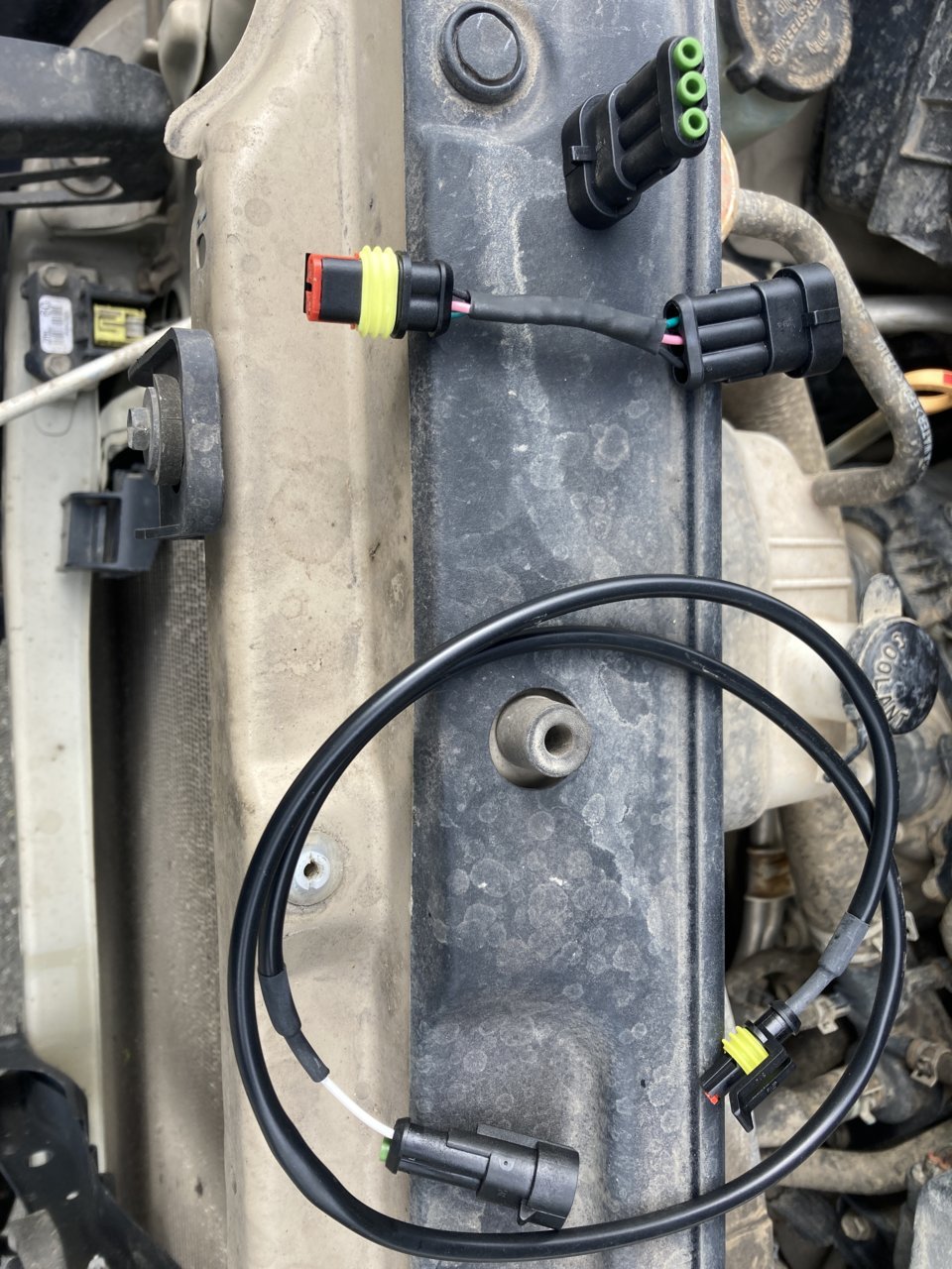

    I’m getting stuck trying to wire up the dd backlight…I have all the connectors for the led headlight done, but using the grill connector and rest of the harness components are stumping me. Any guidance here would be great.
    These are the harness components I’m struggling with.
    I dont know how those can connect to the dd harness even if I combine them..when I do I’m left with two male connectors (one from dave’s harness and one from the fog light). I presume I don’t need to use the braided wire/connector that came with the dd fog kit right?

    I got gender wrong. Looks like their harness is female input for backlight but male H9 for fog. I was expecting two boys. I’ll send you and @mlr69 a pair of male to male jumpers.

    No worries. I thought i was going crazy or something lol. Let me know if you want any photos of the dd harness just for future reference.

    Just a quick confirmation that the two ends are exactly the same connector?
  20. Apr 13, 2022 at 6:12 PM
    #280
    piotr1aj
    piotr1aj Well-Known Member
    Aug 31, 2017
    #228685
    149
    Seattle, WA
    ‘17 OR QS/DCSB/MT
    yup exactly the same
