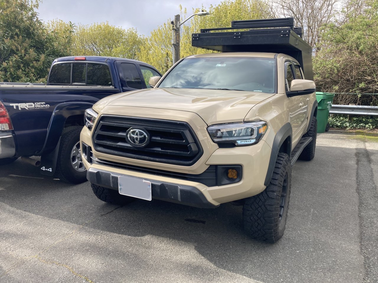

    Finally installed the new LEDs! Thanks again @daveeasa for the new harnesses with dd backlight compatibility. Taco mods almost near completion lol.

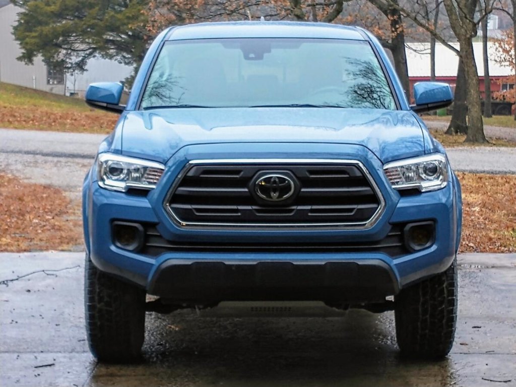

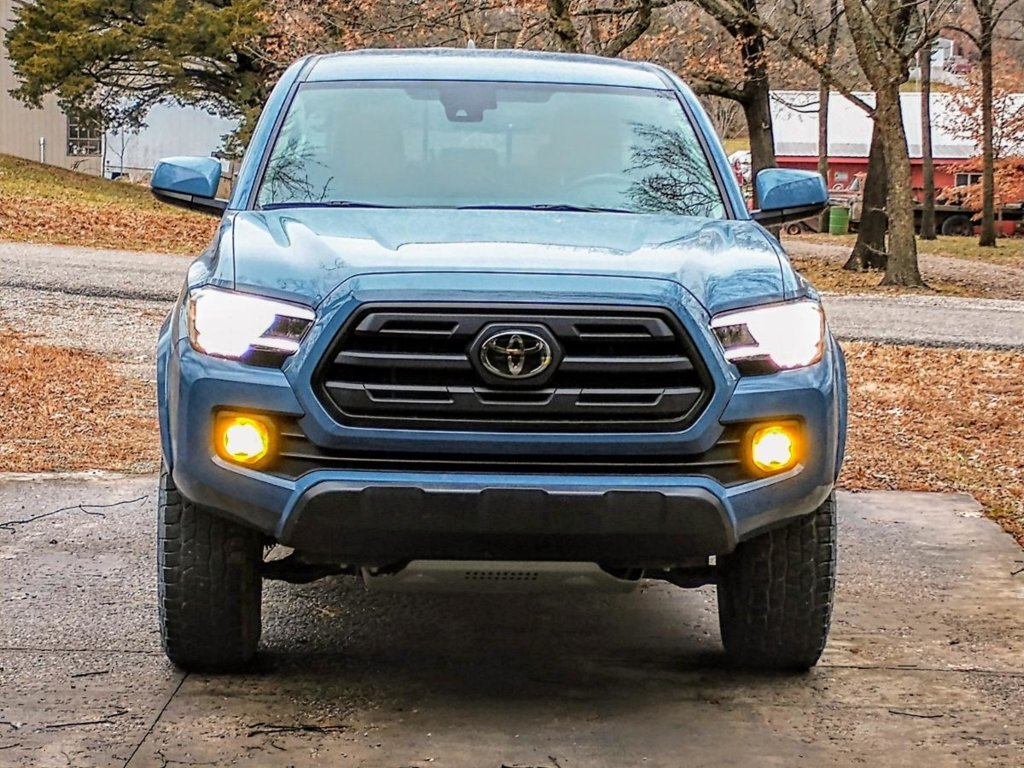

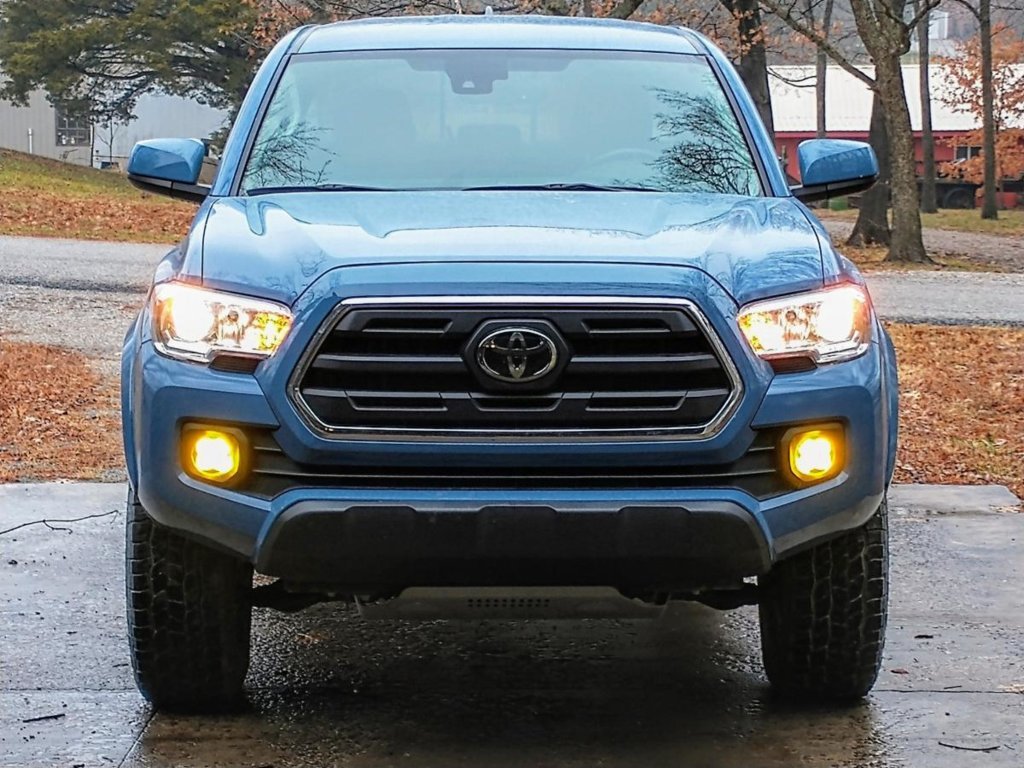

    Not great pics but...
    Before:
    After:
    The harness from @daveeasa made wiring it all up a piece of cake. Two thumbs up.:thumbsup::thumbsup:
