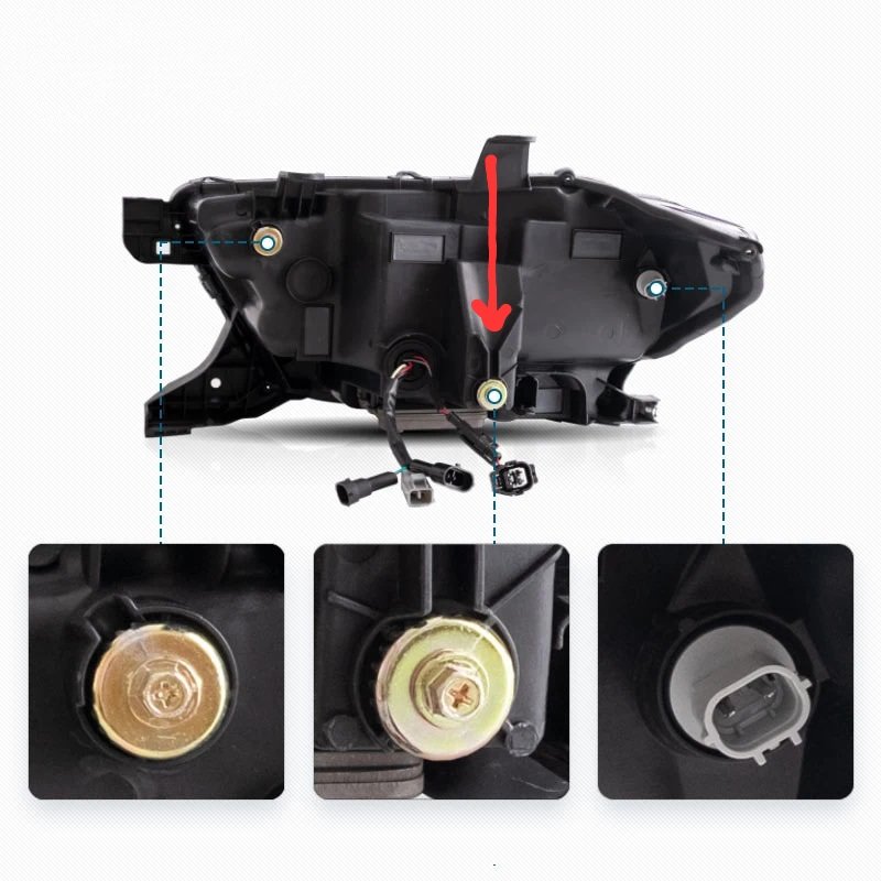

    Finished installing my OEM LED headlights today and noticed that they project pretty low can anyone tell me how to adjust them? Can seem to find a video on YouTube either. Thanks

    There is a screwdriver adjustment on the backside. You'll see a hole with a funneled opening, stick the Phillips screwdriver in there and turn (the screwdriver, not your body).
    Auto-Lamp-LED-Headlight-With-Full-LED-Lens-and-Sequential-Signal-For-Toyota-Tacoma-2015-2016.jpg

    just need the screwdriver like @Bertw192 said

    You don’t need a screwdriver. You can adjust with your fingers. It gives you more control and prevents you from causing any potential damage.
