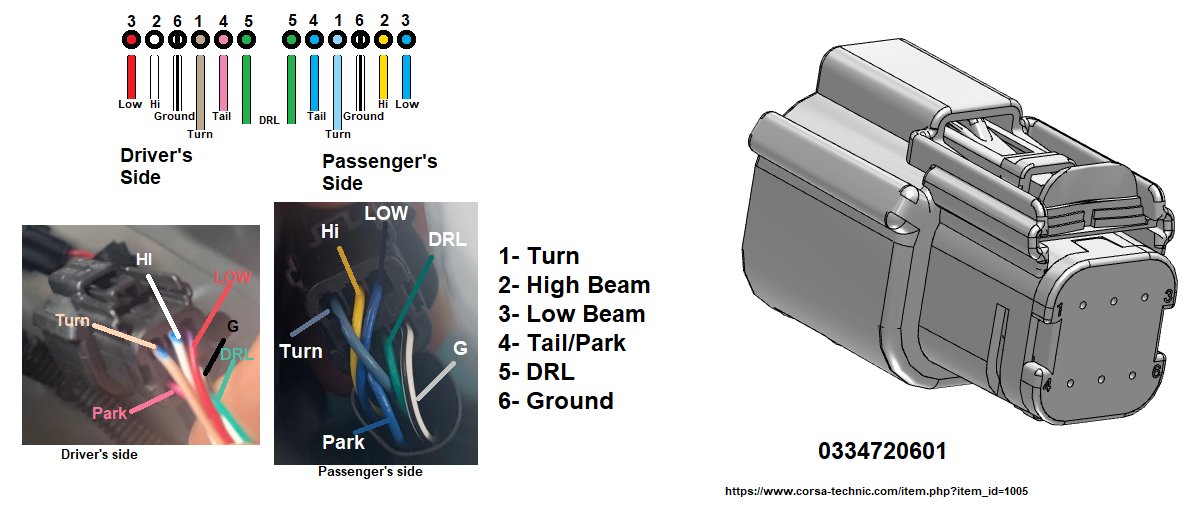

    Are they plug and play or is there modification needed for swapping the oem LEDs with my oem halogens?

    You'll need a conversion harness

    Or a snip to the connectors and a crimp for the mx150 connector terminals...faster & cheaper and will look OEM for the dealer.

    It's the connector to the LED headlamps. It would substitute the various connectors the Taco has into one.
