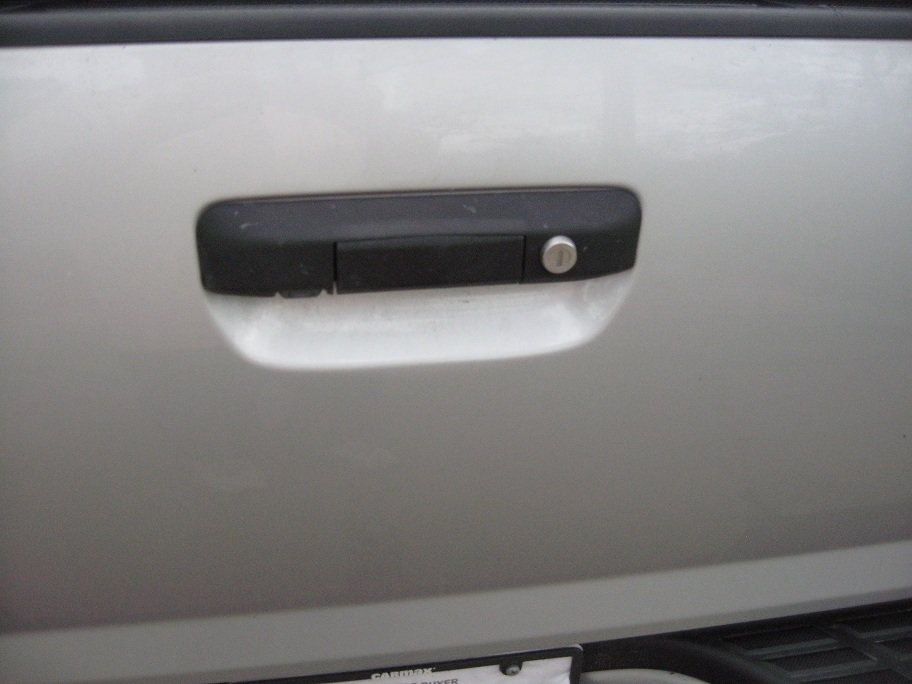

    12' reg cab 4x4 2.7L auto
    I ended p with a P&L premium on my tailgate. While it was a easy install I am concerned about long term durability. Although. Don't drop my tailgate that often when I do the handle doesn't feel firm. It feels like if too much pressure were applied it would break. Also, with the premium the finish is coming off. It has only been installed about 3months and after only a month the finish started peeling.
    All on all, I like it as I feel a little more secure with it installed.. The finish doesn't bother me that much and I will ALWAYS be very careful when opening the tailgate as to not break the handle.

    I have checked mine 3times to make sure the install was correct and there is no binding. All looks good and appears to be operating correctly. Maybe I am just not used to the feel of it yet. I have only dropped my tailgate twice since the install.
    The finish on the other hand.....not so great. I would snap a couple of pics but the Tacoma is in the garage several miles away. Iw I'll do this later in the week.

    I recognize that this is fairly old thread, but did you ever figure our your PL issue?
    I recently purchased a 2013 Tacoma with the PL + camera and I've got the same issues--not a smooth opening action (I've got to muscle it to get it open) and the black finish is already fading.
