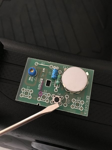

    I noticed my opener has two switches soldered to the momentary opener button. I wonder which two to solder to? Anybody know?

    I need a close up photo of the backside
    Do you have a digital multimeter?

    Thanks guys. I just took a safety pin and went across the two side terminals momentarily and it worked. Now i can solder lol

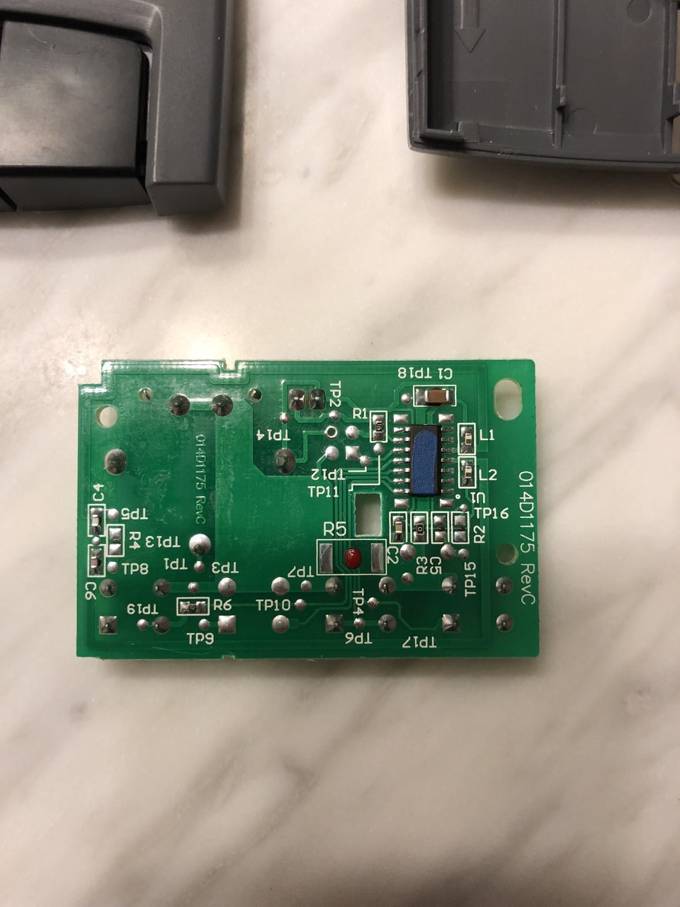

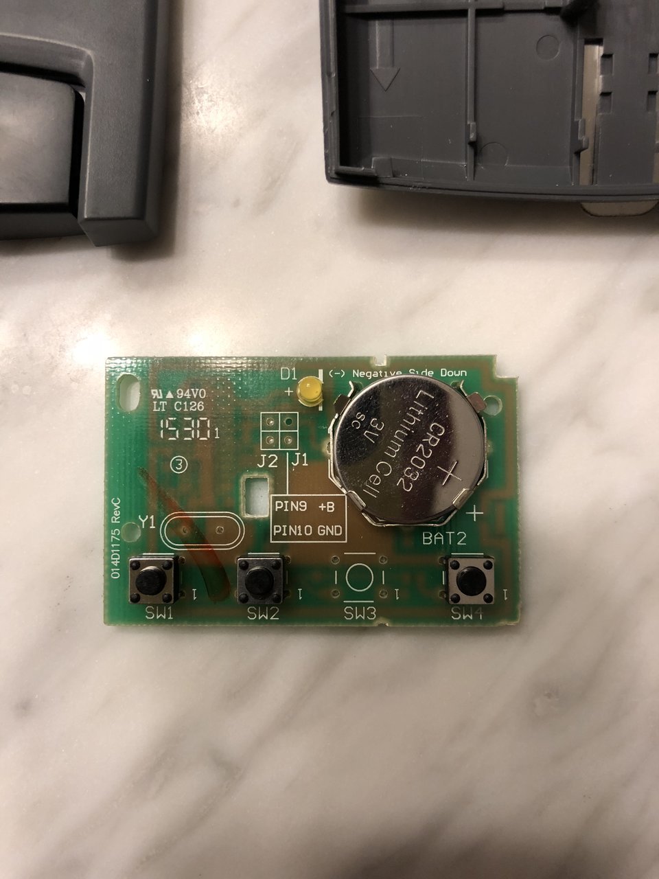

    Not sure if anyone still follows this tread but if so I too am looking for guidance on wiring to my specific opener. (I have the same switch and harness listed in the OP)
    Opener has 3 buttons but I only plan on using the one (SW2 in the pic below). I’m clear on ground and lighted source if I go that route. Just wondering where I need to wire my red and green to the GDO. Looks like each button has two sets of soldered connections, similar to the one listed earlier in the thread. Any insight is appreciated. I’ll pick up a multi meter tomorrow so see what I can find on my own too.

    Pick two that seem logical and short them with a jumper wire. If the door operates, they're the correct ones. If not, try another pair. I think mine were diagonal.
