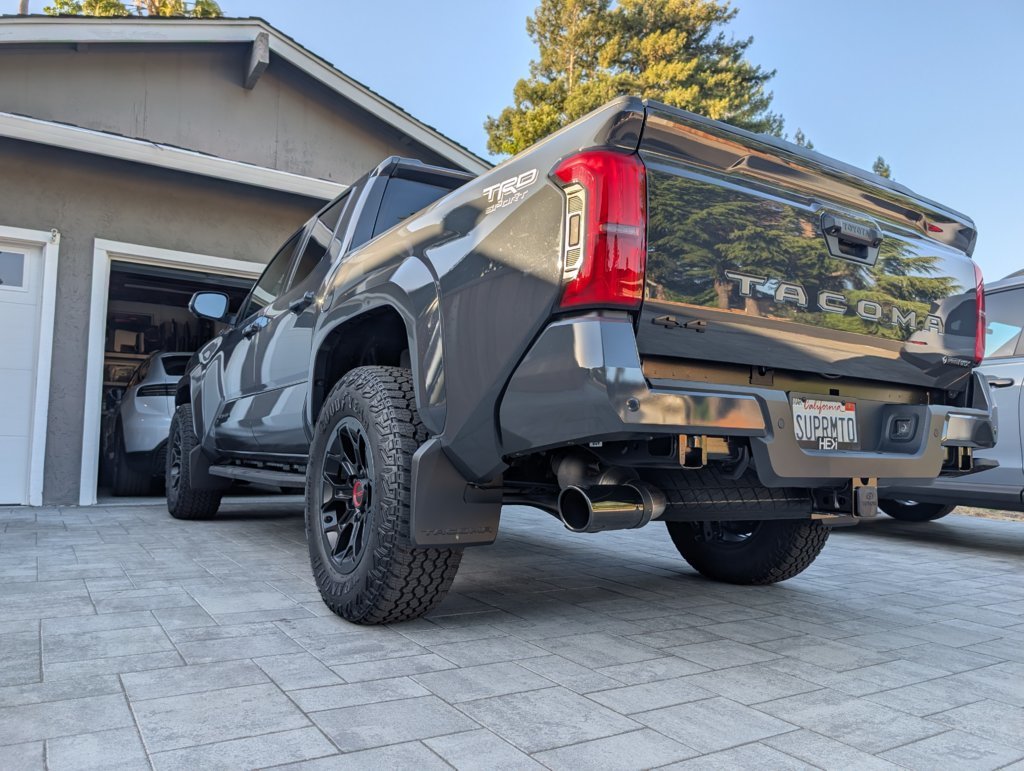

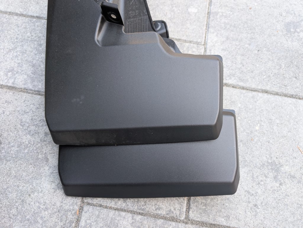

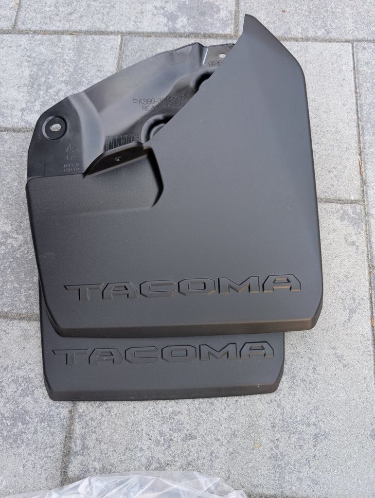

    I hope this helps for people who are looking to order the newer/wider OEM Toyota mud flaps.
    There are 2 versions of the 'Canadian' flaps which are much wider than the original stock mud flaps from 2024.
    I originally had the 00 version, which worked great on my stock TRD Sport wheels, but when I upgraded to the TRD Pro wheels which has 20mm more positive offset, I decided to buy the 50 version of the flaps. I encourage anyone who wants to run OEM flaps and has more positive offset to run the wider mud flaps as it will offer more protection.
    PK389-35R50-P1 <- Wider and made for TRD Pro/Trailhunter
    PK389-35R00-P1

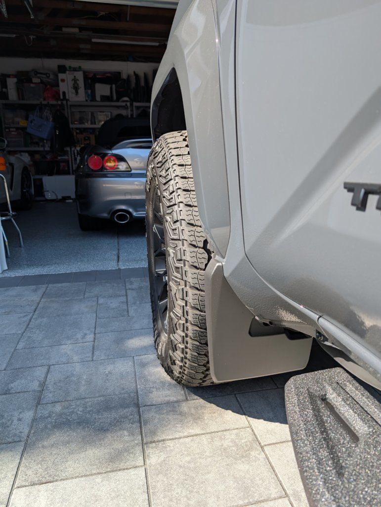

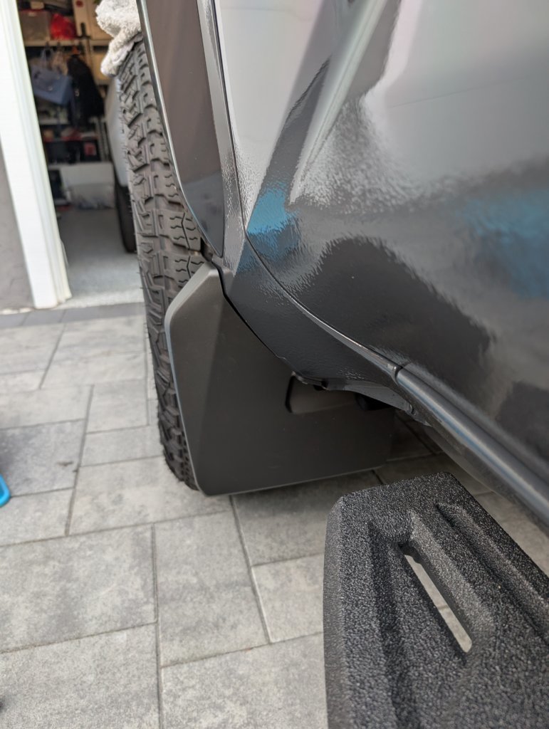

    I put a strip of PPF over the mudflap touch points 1500 miles ago. When I removed the smaller flaps to install the bigger ones, I examined the PPF and there were no rub marks or any signs of wear. I'll remove the flaps to clean intermittently.
    Yoda's TRD likes this.
  5. May 7, 2025 at 9:06 AM
    stan23
    stan23 [OP] Well-Known Member
    Jun 20, 2014
    #132351
    2,462
    stan
    Santa Clara, CA
    2025 DCSB TRD Sport 4x4
    Pic of my PPF job.

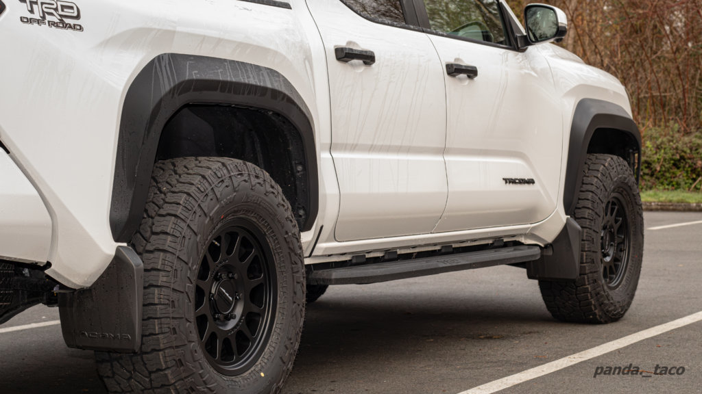

    I'd assume it would work for all 4th gen trim. The author of this thread has it on their TRD Sport trim. I have it on my TRD OR.

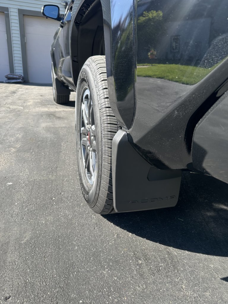

    I’ve got a ‘25 Sport and these are the Canadian mudflaps
