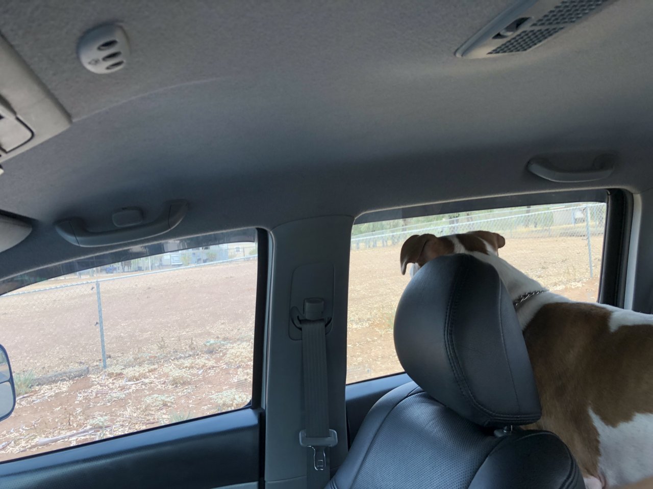

    Bumping an old thread.
    Does anyone know if the double cabs have threads/mounts for an oh sh*t handle, for the front seats, in the proper location for one:
